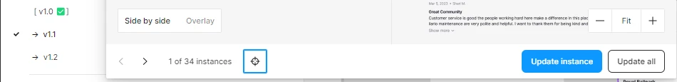

I often need to update component instances on a specific page without affecting those on other pages. However, Figma currently requires me to go through every instance across the entire file, which is frustrating — especially when working with versions and wanting to preserve old designs.

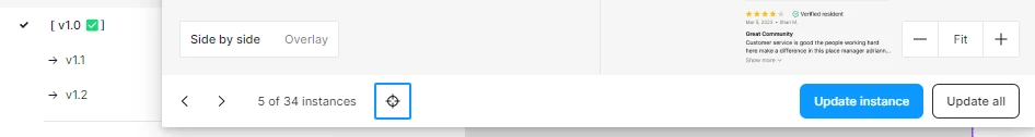

While the "Review Updates" panel could help, it actually makes things worse because instances are not listed in order. For example, instance 1 of 34 might be on Page 3, while Instance 4 is on Page 1, making it incredibly tedious to track and update only the relevant ones.
A "Update on Current Page Only" option would be incredibly useful, allowing users to selectively update instances only on the active page, without affecting other pages. This would greatly improve workflow efficiency, especially for large projects with multiple design versions.
