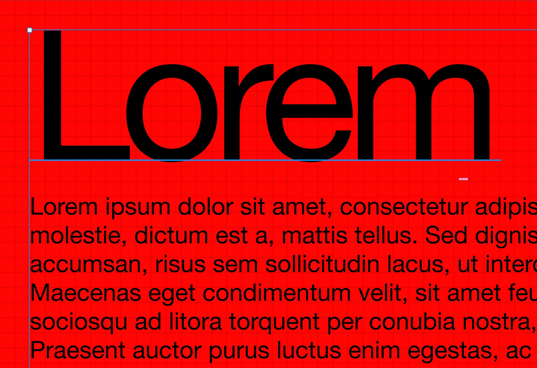

Right now, it's impossible to left-align stacked text layers with different font sizes inside Auto Layout.
Because Figma aligns to the text bounding box instead of the actual glyph bounds, font sidebearings create an awkward visual gap. For instance, if you place a 120px heading starting with "L" above a paragraph of 16px body copy, the stem of the headline won't line up with the flush left margin of the body text.
  • You can't manually nudge text layers inside Auto Layout.
  • Negative padding isn't a fix because it shifts the whole container, not the individual text layers.
  • Community plugins like “Text Visual Alignment” only works with freeform layout.
How to recreate the issue
  1. Create a large headline starting with a straight-stem letter like L, E, P etc.
  2. Place a paragraph with body copy underneath it.
  3. Put both in a vertical Auto Layout frame with left alignment.
  4. Notice how the stem of the “L” sits visibly further to the right than the body text below, because the massive sidebearing gap on the 120px font pushes the letter away from the left edge of the frame.
Solution:
Add horizontal trim to type settings (right next to vertical trim) that crops the sidebearings to the outer edge of the glyph bounds. This would let headline stems snap directly to the left margin of body text, giving us true visual left/right alignment inside Auto Layout.
