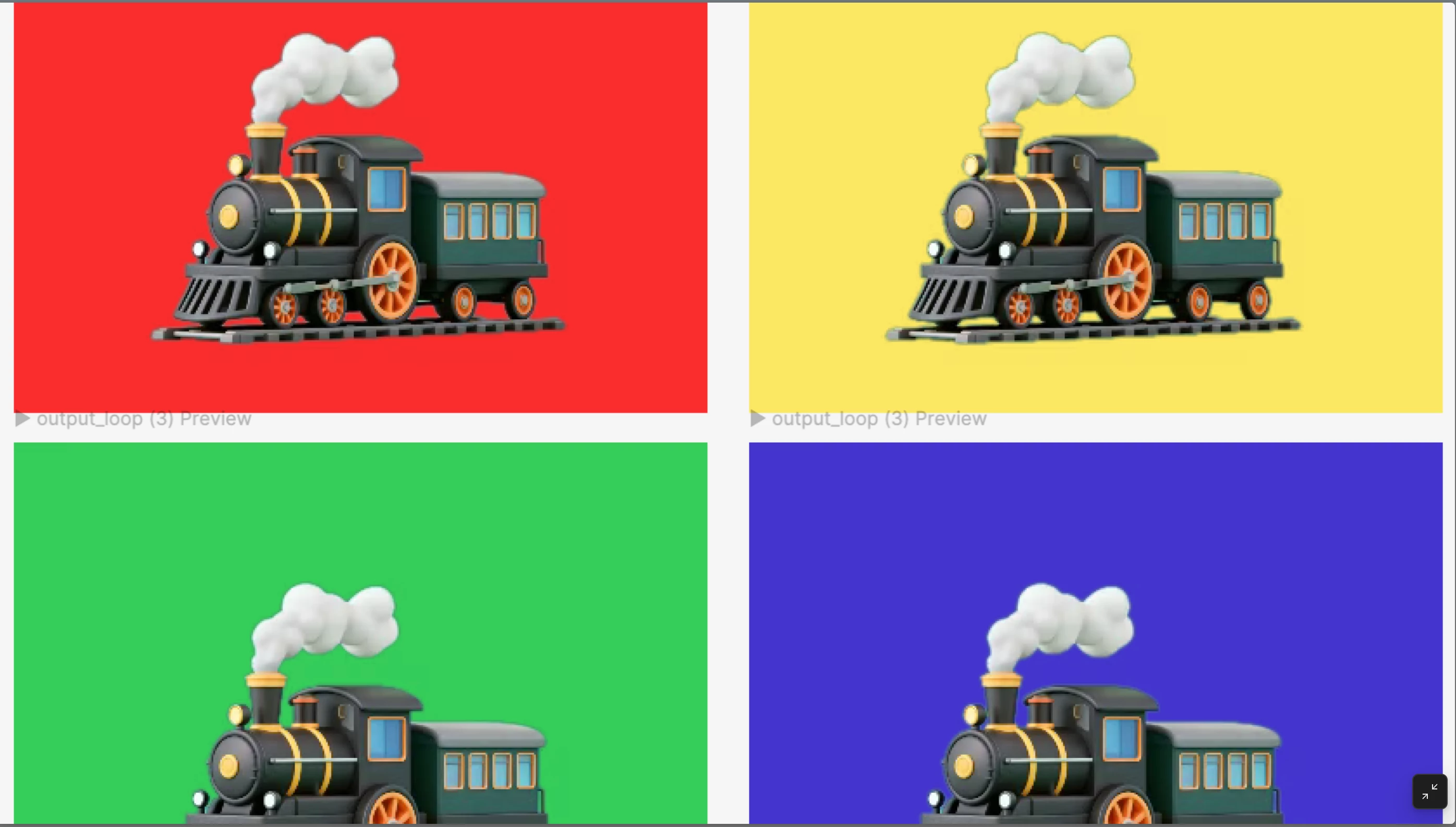

    Slava_Bronevitskiy
    Active Member
    May 31, 2024 9:48 AM UTC
    I did some investigating and discovered that when you create a fresh transparent video file (hevc mp4 at least, maybe vp9 webm too) transparency works perfectly in Edit mode and Prototype mode.
    Transparency gets lost if you:
    • Duplicate the layer (duplicate will lose transparency)
    • Change selection to a duplicate that is broken, then go back selecting previously working layer
    • Likely other actions
    Things tried to revive transparency, but failed:
    • Reloading tab
    • Deleting video layer and dragging video file again into the same Figma file
    • Creating a fresh new Draft file and dragging the video there (if transparency for this file was lost previously, even the first drag is instantly black)
    • Renaming the file in OS and dragging that into Figma (agian instantly black)
    • Switching between desktop app and browser (Chrome, Safari, Firefox)
    Once transparency is lost - can’t revive it.
    Feels like Figma is trying to cache videos or something, getting rid of transparency in the process. Even though it is already fully capable of displaying them properly.
    Since the capability is already there, this is likely to be low effort fix for dev team at Figma.
