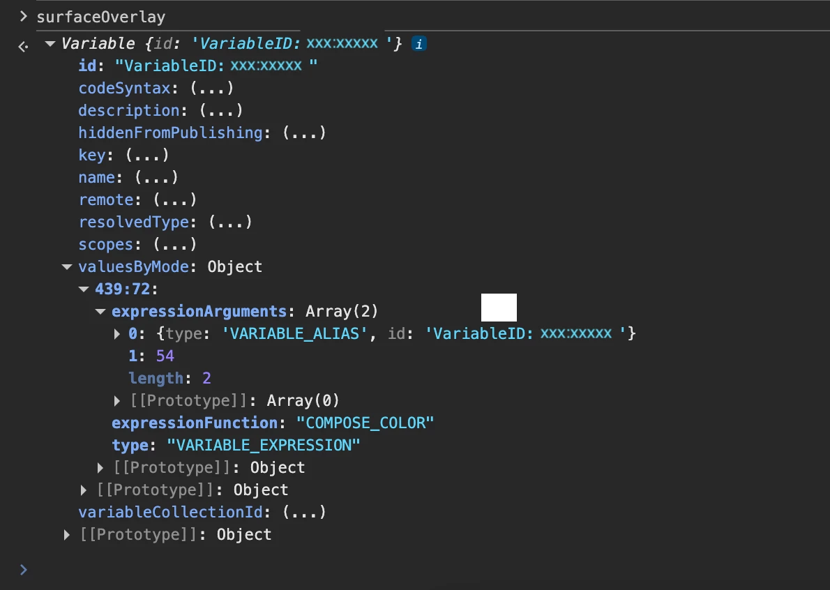

setValueForMode() should accept composed color values, allowing the full script above to run without errors. The resulting surface/overlay variable should behave identically to one created via the UI — maintaining a live link to palette/neutral/900 with a separate opacity override at 54%.
After a successful setValueForMode call, inspecting the variable should show the following structure:
This is exactly what valuesByMode already returns when a composed color variable is created through the Figma UI — the Plugin API should allow writing the same structure back.
