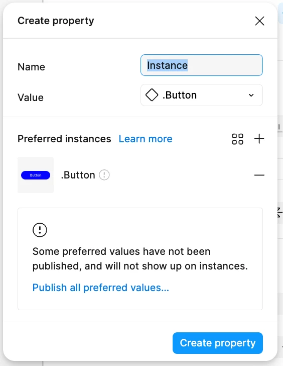

Further, I would like to stress the need for being able to swap base components with others without having them visible in the main Assets pane. As soon as they are hidden, you are not able to swap to them, if they are fundamentally different. We use, for instance, custom made specification markers, which provide a visual representation of a color, a font, a shadow and spell out their token name next to them. The color, font and shadow blocks are different components as they have different properties but we allow for swapping between them on the main marker component. Now, I have to publish those to be able to swap between them, which I don’t want. I want them to be scoped to this parent component only and not retrievable from the Assets pane.
