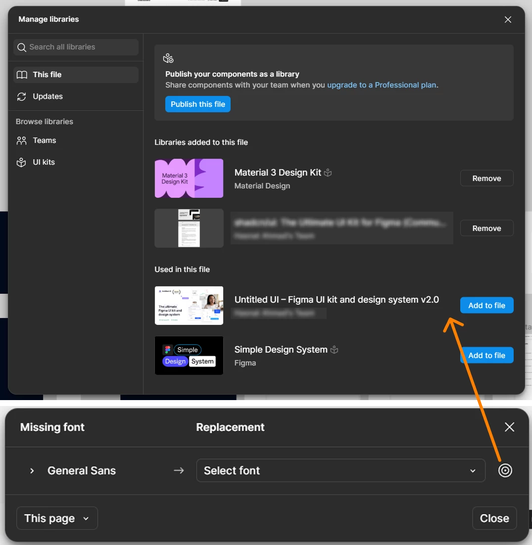

Hi Figma Team,
While working on my project, I noticed that when a file uses components from an external library, Figma mentions “Some components from this library are used in this file” under the Manage Libraries panel.
However, there’s currently no way to easily see which specific components from that library are being used or where they are located in the file.
It would be extremely helpful if Figma provided a way to track or highlight the components used from each library, for example through a “Locate components” button. This would make it much easier to manage dependencies, replace assets, or clean up unused libraries.
Could you please let me know if there’s currently any way to check this, or if it’s planned for future updates?
Thank you!

Hi, I have the same issue. If you click on the thumbnail of the library of the left (not on the name), it will show you which components are used, but there is still not way to check WHERE in the file it is used. Also when I search for the name of that component accross all pages of my file, I get no results.
