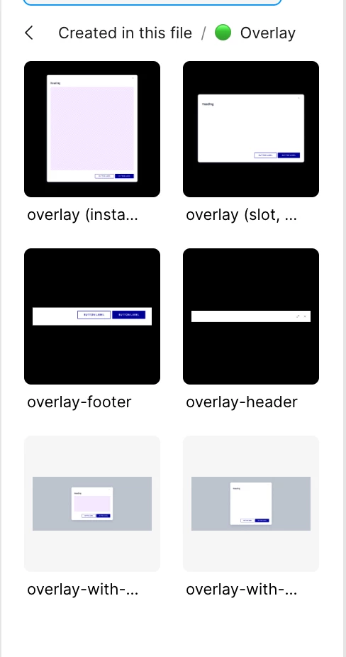

Jul 1, 2026 8:18 AM UTC
my design system uses a 0.1% opacity black background in the component container (or parent section). This causes the components in the assets panel to have a black background and be recognisable as “do not use”. There are many problems with this approach, but I haven’t found anything better…
