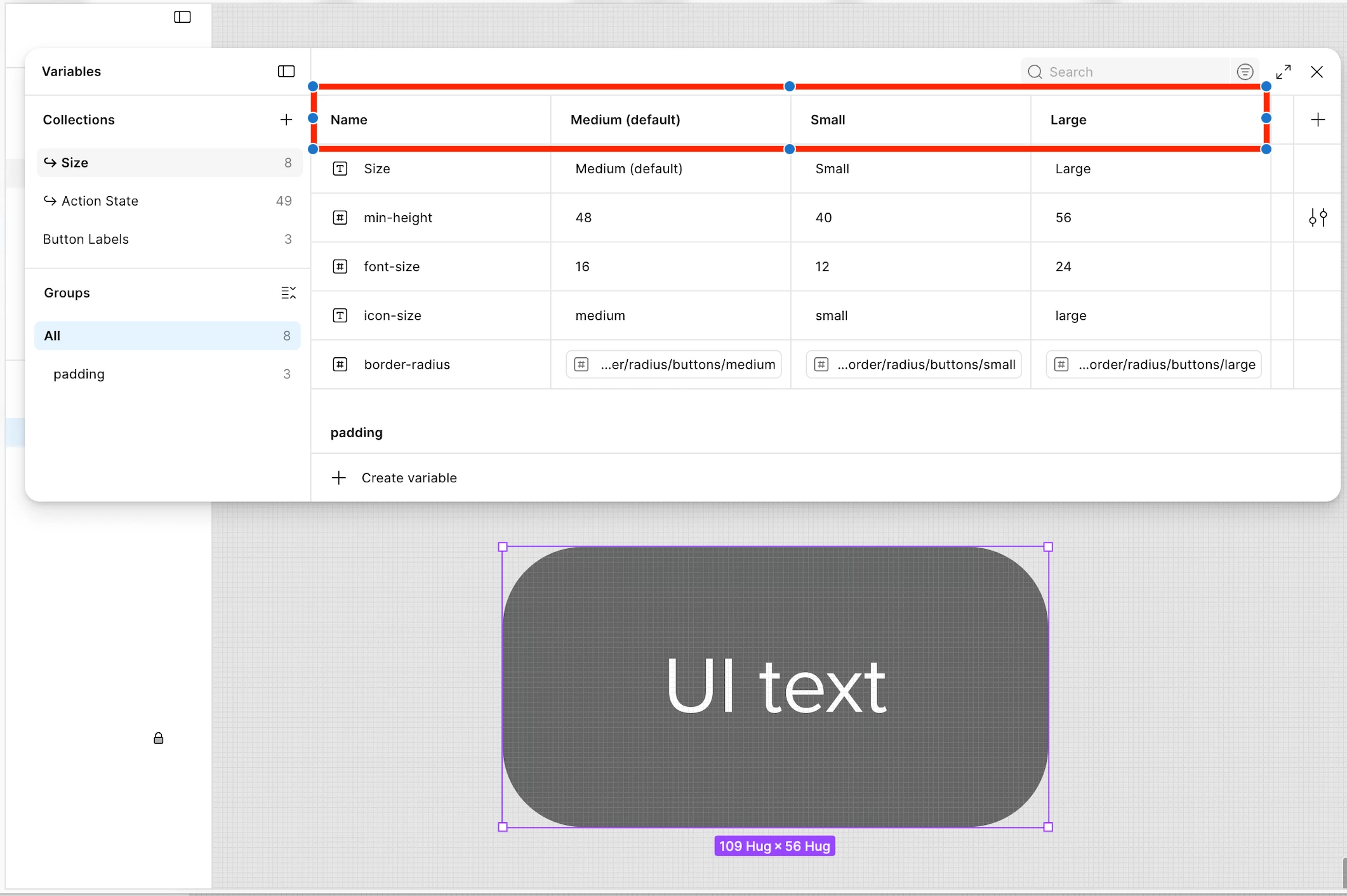

    OK, my team and I have found a workaround. We’re using a combination of Modes with a controller variable, and adding a text prop hack/workaround.

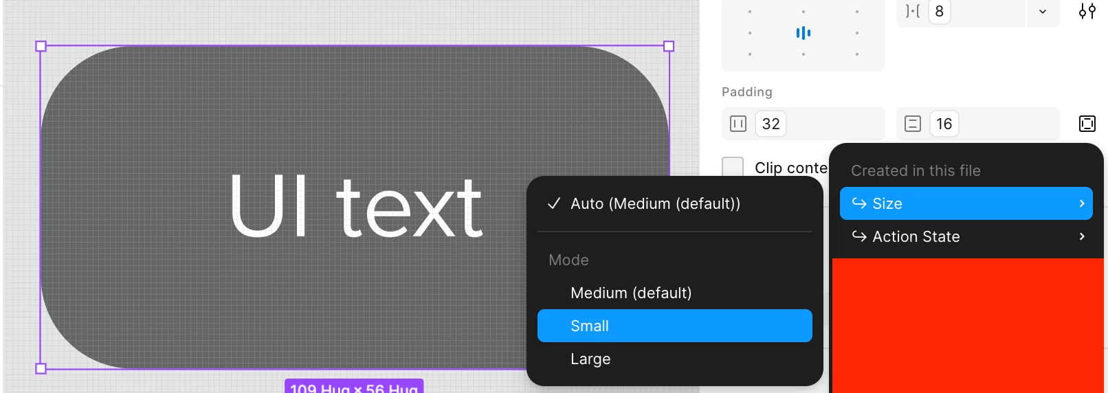

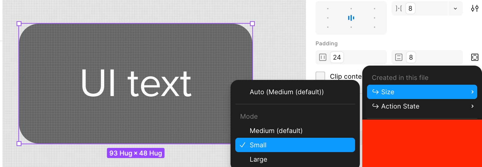

    Set up the mode, in this case, size. We have Medium (default), Small, Large

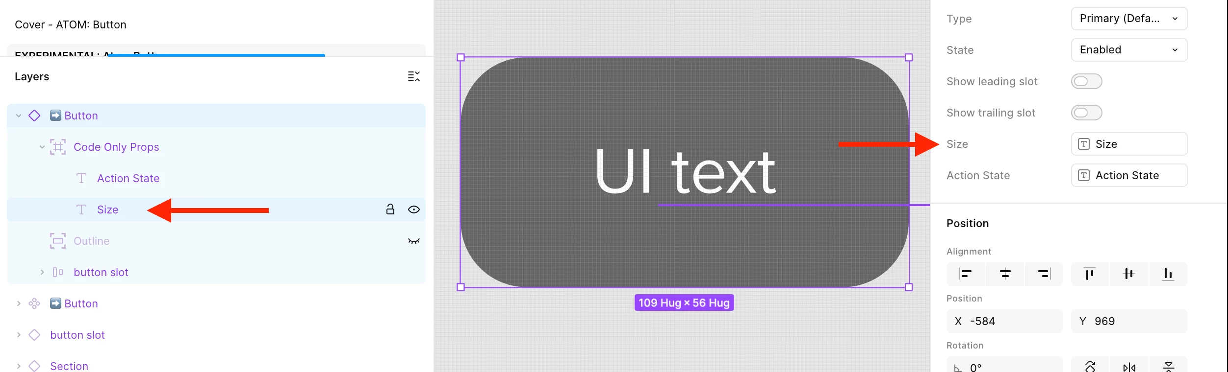

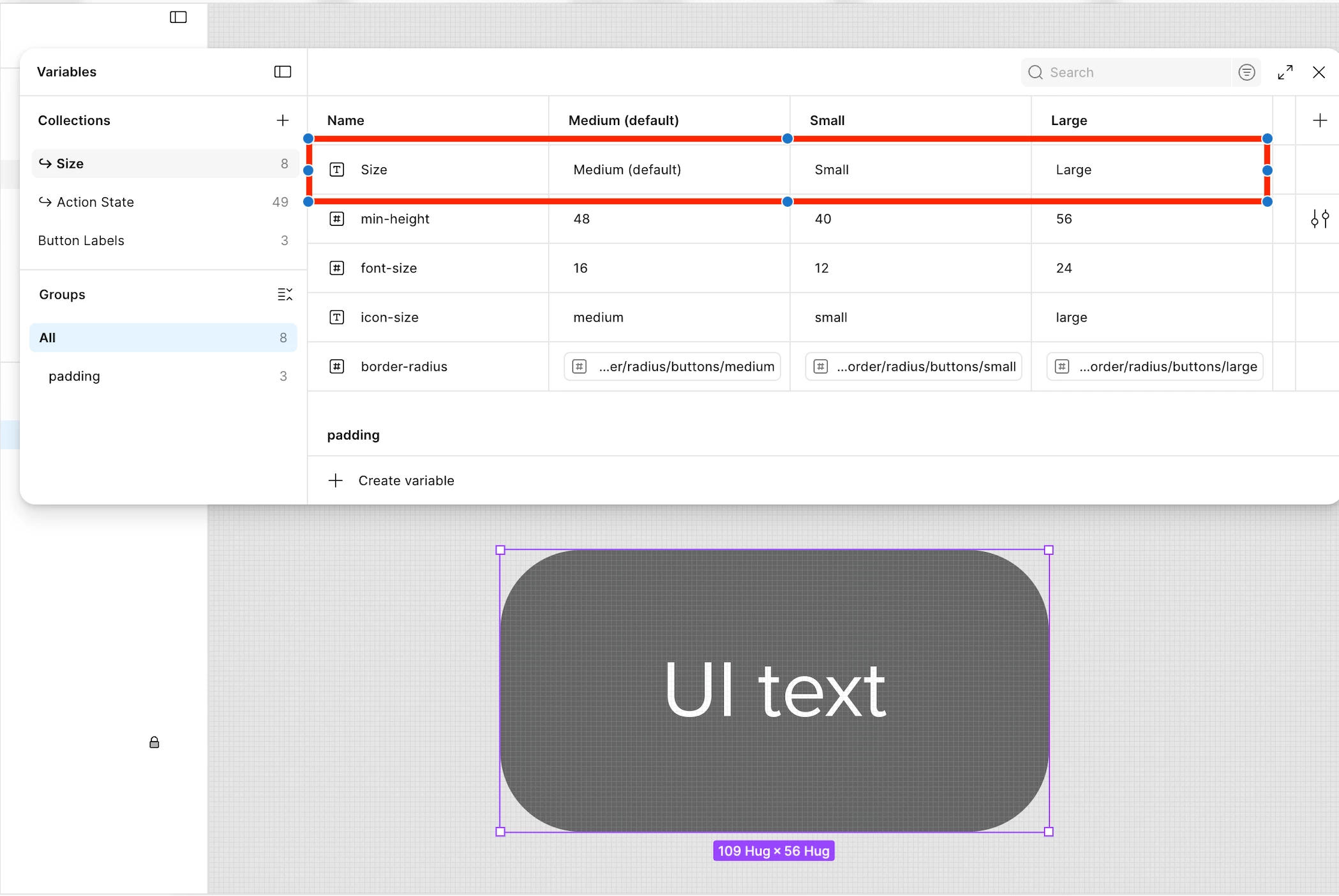

    Set up a “Size” text variable, and name it the EXACT same thing as the mode name.

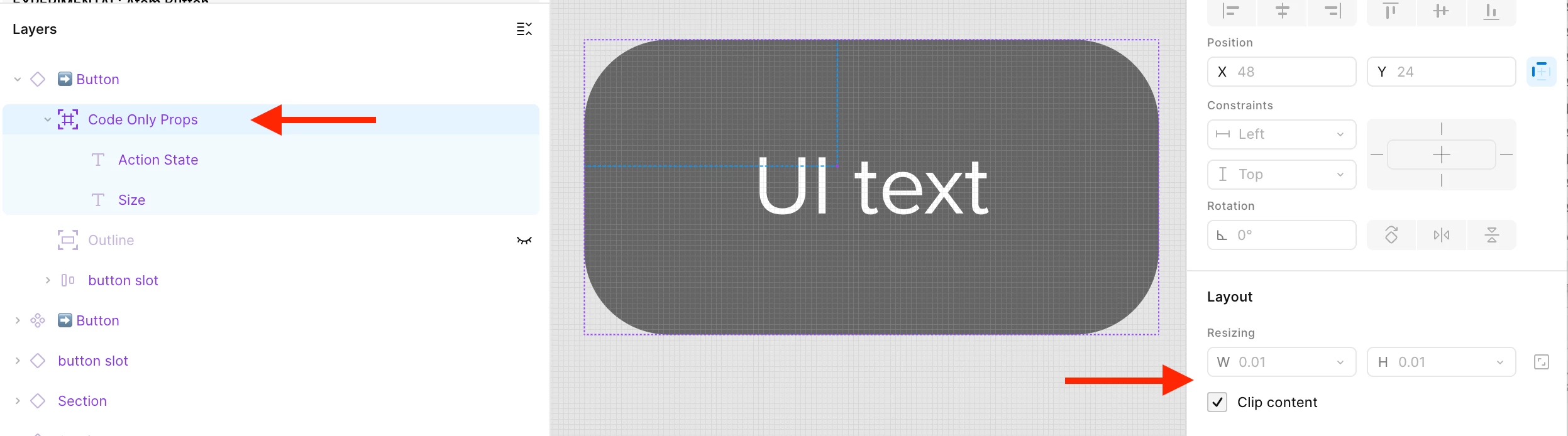

    Create a “Code only props” frame, and add the Size text field, assign the Size variable to the text property.
    On “Code only Props” frame, use “clip Content” and set the width/height to 0.01/0.01. This in essence hides it, but makes Size accessible to Code Connect to target.
