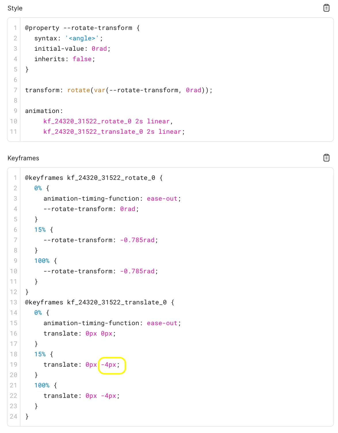

Our company uses the new motion mode to implement animations, and we have a token system to tokenize colors, spacing, and also animation duration etc.
I noticed that as a Dev I am unable to see which tokens have been used. The automatically generated code infers the values instead of showing the tokens:
The 4px should be a token in this case.

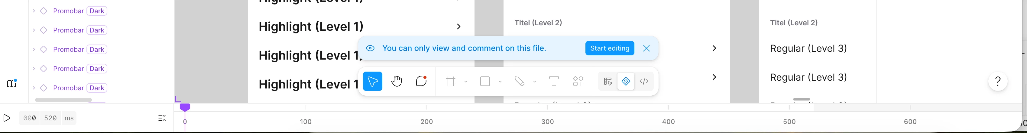

I also don’t have a full seat so I am unable to even see the animations in the timeline:
Feature Request: I think it would be great to have the option to read the animation here, even if you don’t have full access.
