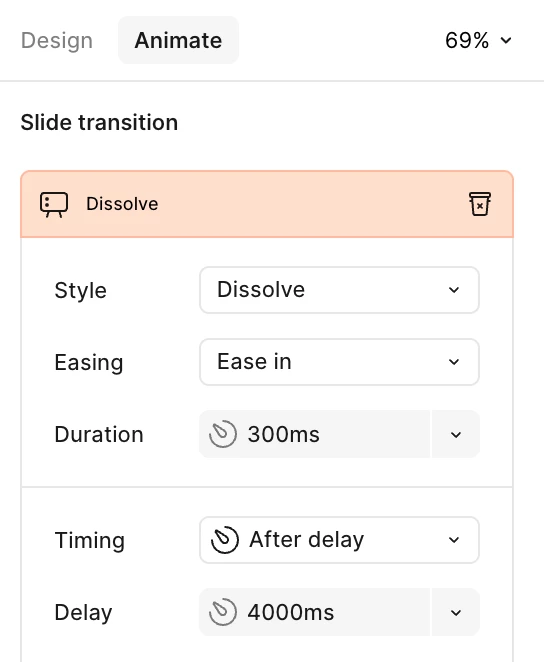

Setting something like this up should be doable on Figma Design with prototyping, basically you need to use the After Delay interaction and set your desired time there. To make it loop, just add the same After Delay interaction from the last slide back to the first slide.
Only con of sorts is that you'll need to set this up across the entire presentation, but Figma will mostly remember the setting you've configured.
Slightly tedious mostly, but can be handy until this feature gets added into Slides

I have done it in the past with prototypes:
I connected all slides and set a timed transition for a few seconds so it goes to the next slide automatically, and on the last slide, same transition to the first. When you play the prototype it loops until you close it out.
It’s a workaround i used on screens in conventions and parties.
