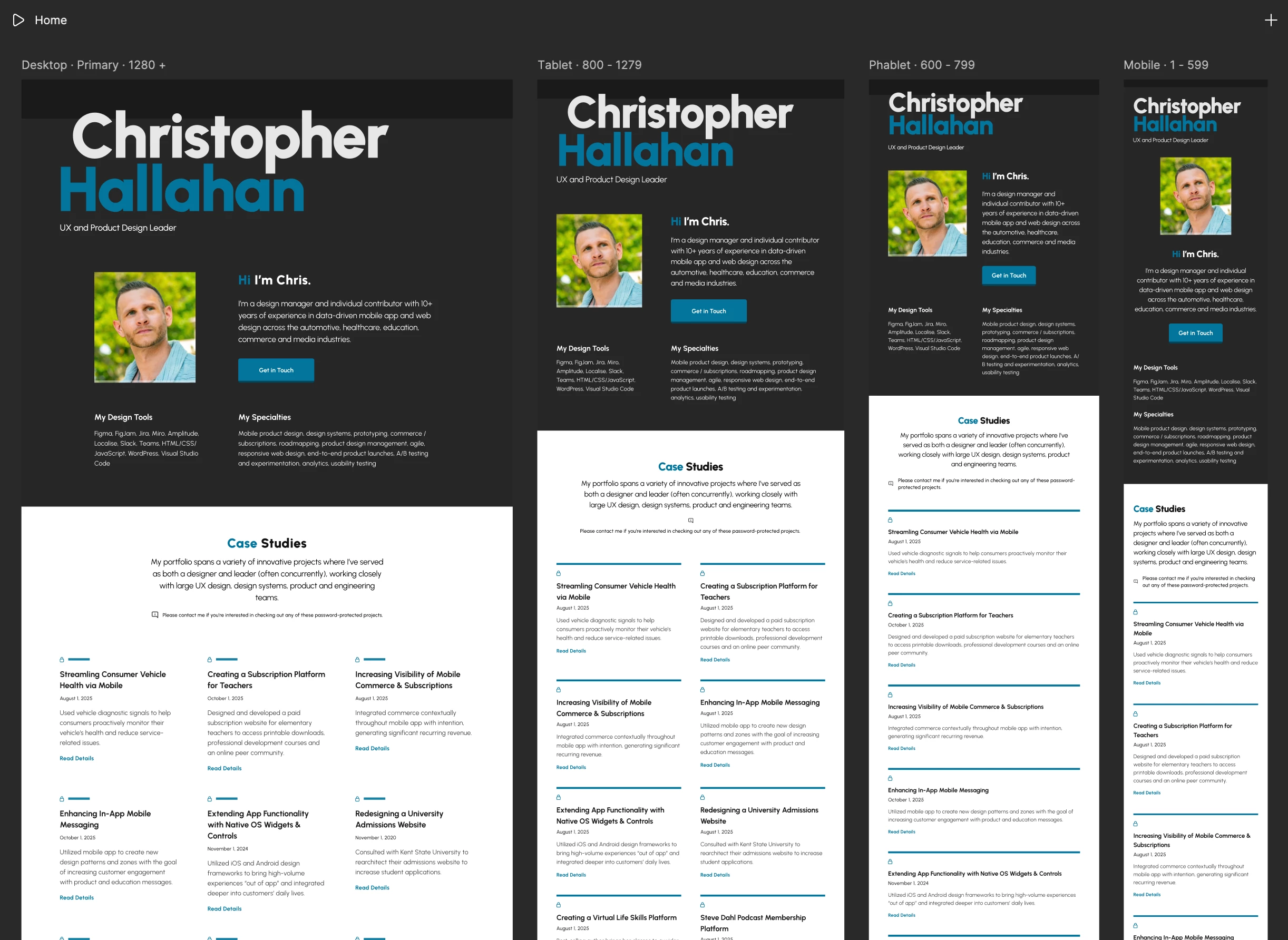

Just moved my simple UX design portfolio website from a CMS over to Figma Sites. It’s a bit of a learning curve, but pretty impressed with the functionality so far! I’m used to designing and developing my own websites and themes from scratch using a CMS, so my expectations are pretty high.
Some stray observations:
  • First off, this is labeled a beta and it definitely is. I wouldn’t use this for anything beyond simple personal sites or prototypes as of yet.
  • Getting custom fonts to work took some trial and error. Google Fonts / Adobe Fonts aren’t yet supported, so you have to upload your own WOFF files.
  • Responsive design works really well, but auto layout + fill must be used properly.
  • You can set up components and text styles like normal and then assign them to specific breakpoints, but managing each one can be finicky.
  • CMS functionality works well, but is pretty limited right now. For example, no way to display a random set of posts or set custom cropping for images.
  • Password protection is available by the entire site or by collection (not individual pages/posts). Wish you could do it on a per post basis.
  • There’s some pretty sweet interactions/animations built in, saving a lot of time vs. a custom implementation.
  • I tried some of the Make/AI features (ie for creating an image carousel). I ended up not using it - too difficult to make changes and customize after the fact. I would much prefer official starter components for things like carousels that can be customized.

I’m doing the same currently and can’t agree more.
It’s a fun little playground but not worth considering for real projects (as of now)
However, if they develop this further this might actually become useful, yet I’m still worried about the SEO perspective.
