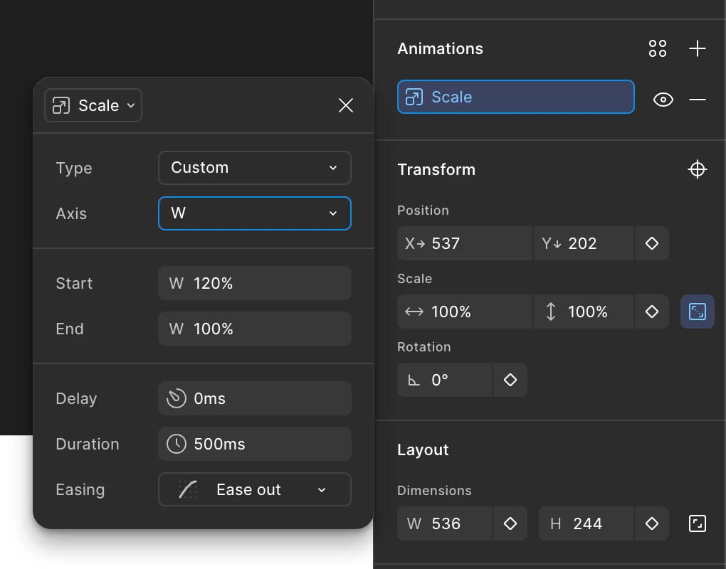

Hey, ​@Cammy Hogg! Thanks for trying out Motion. Hopefully this hasn’t been too confusing an experience for you. There are actually two ways to achieve this depending on how much you want to customize it.
The quick way.
The simplest way to do this is to use the pre-built Scale animation. After switching to Motion, click the + in the Animation section of the Properties panel, then choose Scale. For the type, choose Custom and then for the axis option choose Width. This scales from the center as you are expecting.
A screenshot showing the Scale animation configured for width.

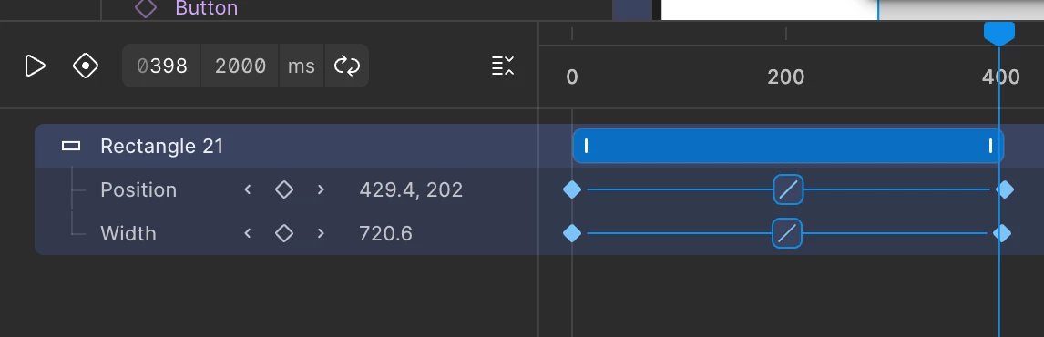

If you want to do this manually so you have fine tuned control over each part of the animation, you’ll need to animate both a change in the width and a change in position. Essentially, you need to animate the position in the opposite direction of the direction the width grows at half the amount of change in width.
A screenshot showing both animation layers added manually

I found two more methods;
  • Nest the layer within a parent frame, apply auto-layout to the parent and align children from centre
  • Holding the ‘Option’ key will while dragging (with ‘Auto Keyframing’ on) will automatically adjust position and width, if the object is aligned to centre in Design mode
Regardless, all of these methods feel quite fidgety.
