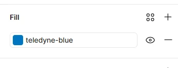

Let me copy HEX code for a color variable
please give me a shortcut to copy variable color, I literally have to hit the “Detach Variable” just to get the damn hex code then hit Ctrl-Z
