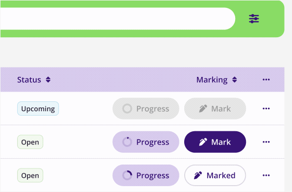

  • Gif export is low quality even it’s set to High. Grey colours show pixelated. I tried to export it at 2x and resizing the file. It does help with image quality but it obviously increases the file size which is the reason for exporting as gif in the first place.

    • The quality setting doesn’t actually apply to the GIF export (hence why when switching to GIF you don’t see the option shown), and GIFs by their nature can sometimes look like that at smaller sizes, particularly depending on how many colors and gradients there are in the source. Having said that, I’m going to check with the team for more info on what is expected here. Could you provide a screenshot of what you are animating on the canvas, and what it looks like as a GIF? I’ll share that with the team.

  • for the gif, I have experience using After Effects and Photoshop to create animated gifs, and I know the settings that would cause this kind of pixelated effect in Photoshop. No gradients have been used, they are all flat colours. Gif is attached.

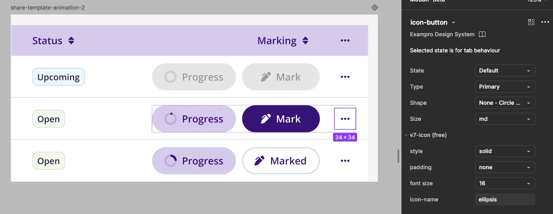

  • There’s a screenshot of a button component where I was trying to change the State property, but no keyframe available

  • No keyframe created for changing a component state property.
    • This is expected, but hopefully this is something we can support - our team is definitely aware of this.

    • I replicated the same animation using After Effects and Photoshop to export the animated gif. Not only it was better quality at 256 colors, the file size was also much smaller by almost 100kb. Figma export was too heavy.
