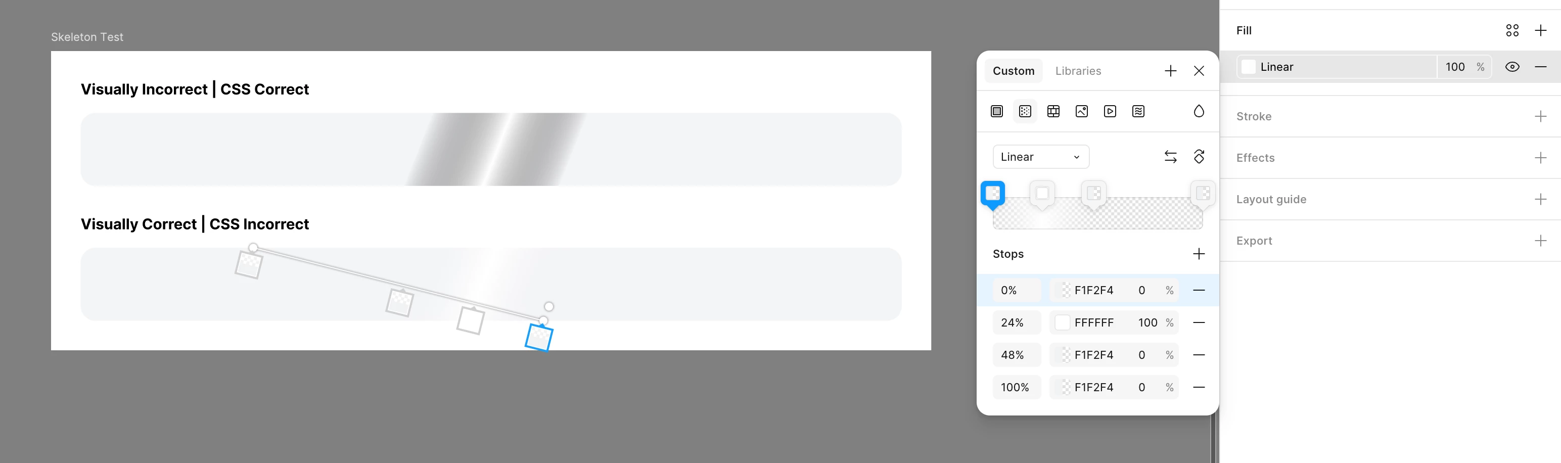

Looking to better understand gradient behavior in Figma.
The example below shows a setup for a Skeleton loading layout/animation. The gradient sits above a background layer with a light grey color.
skeleton reference

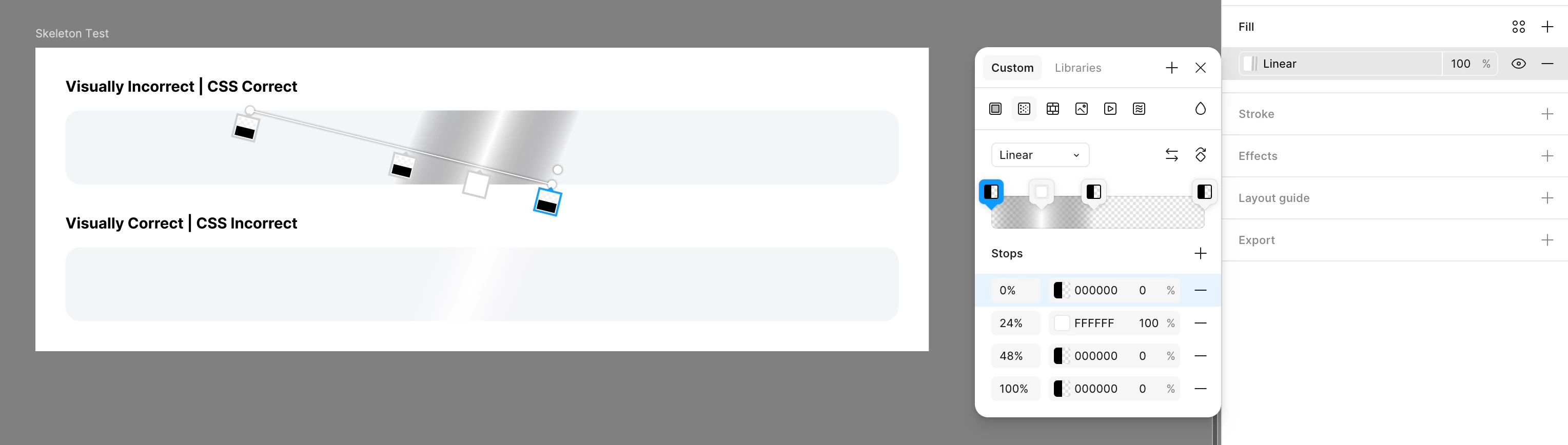

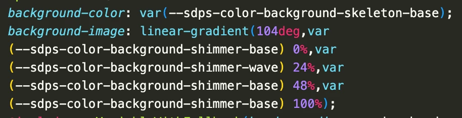

I want the gradient to provide a small white highlight wave, animated across the background layer. It has stops of 0%, 24%, 48%, and 100%. Three of the stops are fully transparent (to match the CSS).
Even when set to fully transparent (#00000000), a fill color is present in the transitional areas. This should transition from white to transparent.
Currently, Figma requires setting the transparent color to match intended visual styling, here requiring setting the transparency to match the background layer. This feels like an unexpected setup step, and clunky.
Is this intended? How does this align to CSS?
