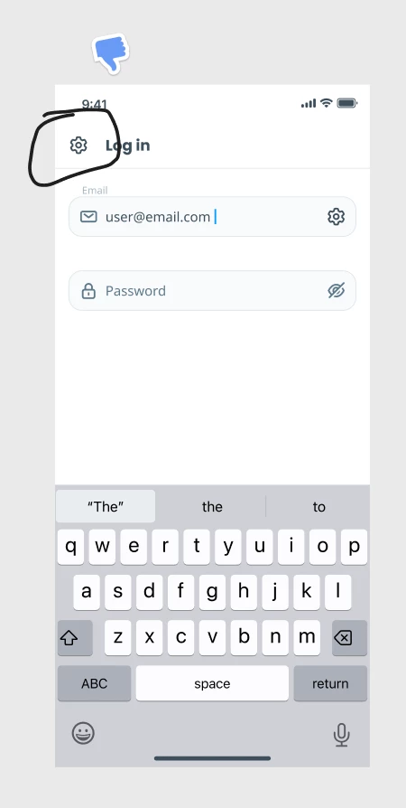

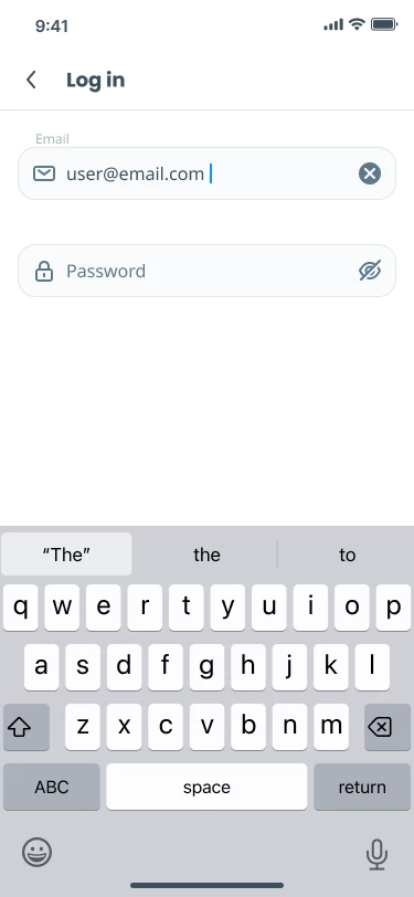

Original frame

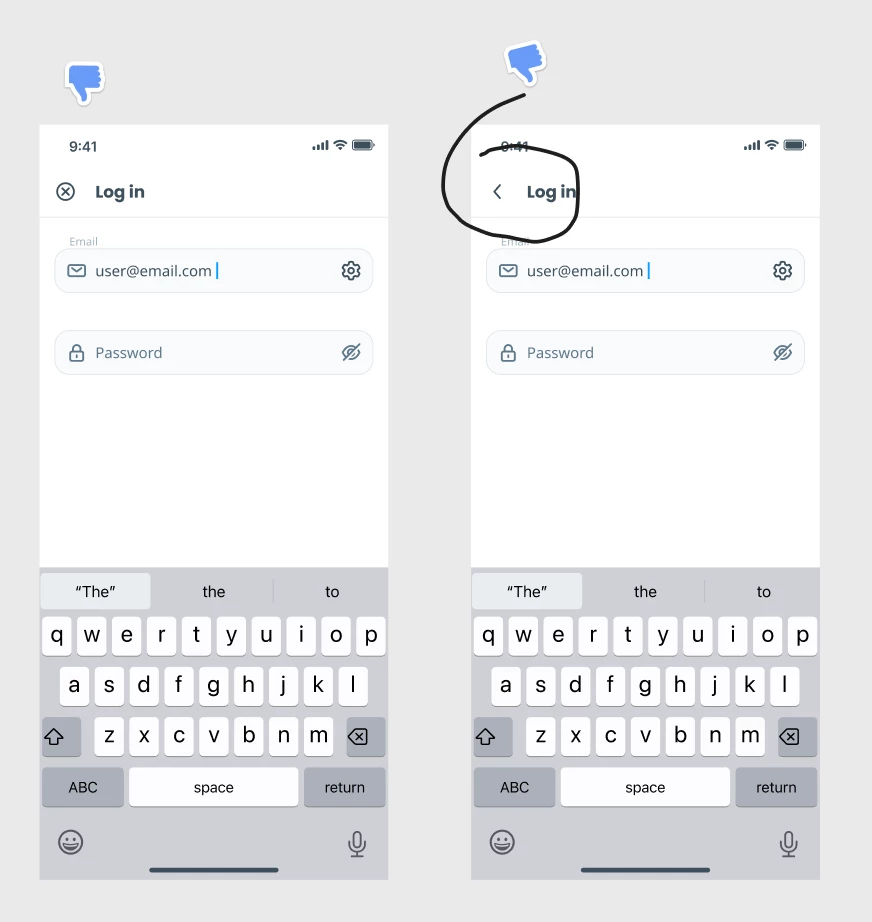

Frame pasted in Figjam. Noticed the icon button on the top nav changed to the gear icon (the component’s default).
Changing to another icon instance, then changing back to the original (No undo), fixes the issue.
It is far too time-consuming to do this fix for all frames and instances. And it doesn’t happen to all icons. As demonstrated on the screenshots, it happened with the back arrow and the “X” clear icon on the email field. The other icons were retained correctly. So it is a bit unpredictable.

Just found a (shitty) solution to this issue! Swap the instance in figma (back button to close button in your example), then reverse that change. Now copy/paste the component back into figjam and it should display the correct instance now. Hope this helps!
