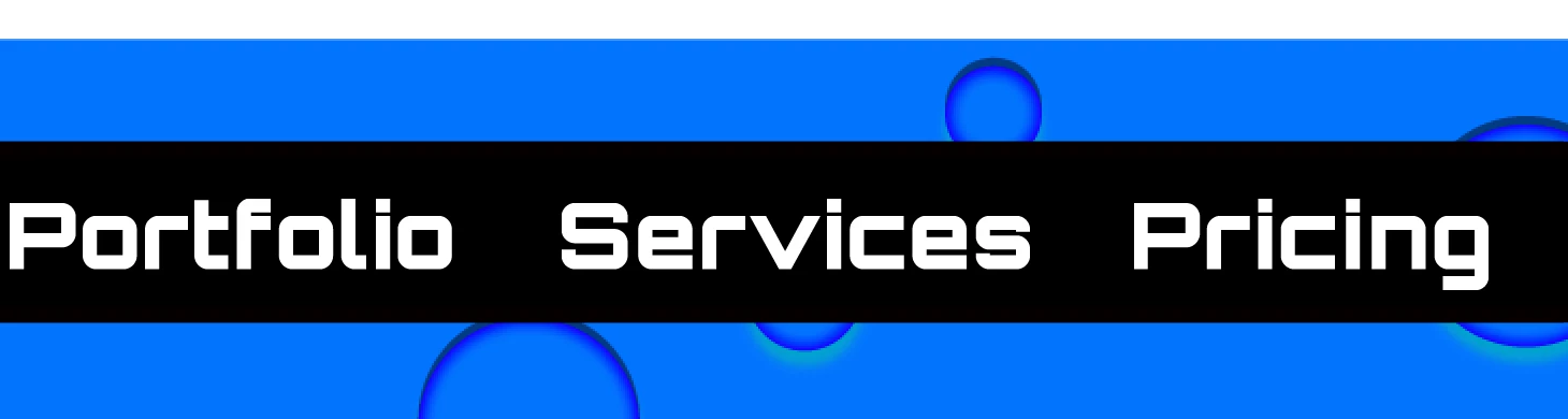

Why is this happening? There is a white space at the top of my website preventing me from being able to scroll up without revealing an awkward and unintentional blanks pot
As said in the title, there appears to be a white space at the top of the website when I have no resources that may have caused this. The frame ends where the hero picture ends and all of my components are spaced intelligently to avoid this.
    Jun 1, 2026 1:10 PM UTC
    Hey ViolentCheese, thanks for sharing the screenshot! One thing I'd recommend checking is whether any elements in your page extend beyond the bounds of the main content frame (for example, layers with shadows, blurs, or objects positioned slightly outside the frame).
    You can also try enabling Clip Content on the parent content frame (Use the Clip content checkbox under Layout). In similar cases, this has helped prevent content extending beyond the frame bounds from creating unexpected white space when scrolling.
    If the issue still persists after trying that, please submit a bug report so our team can take a closer look at your specific file. To do that: go to the Support Hub / Click Start a chat / Type Report a bug, select Enter, and follow the prompts.
