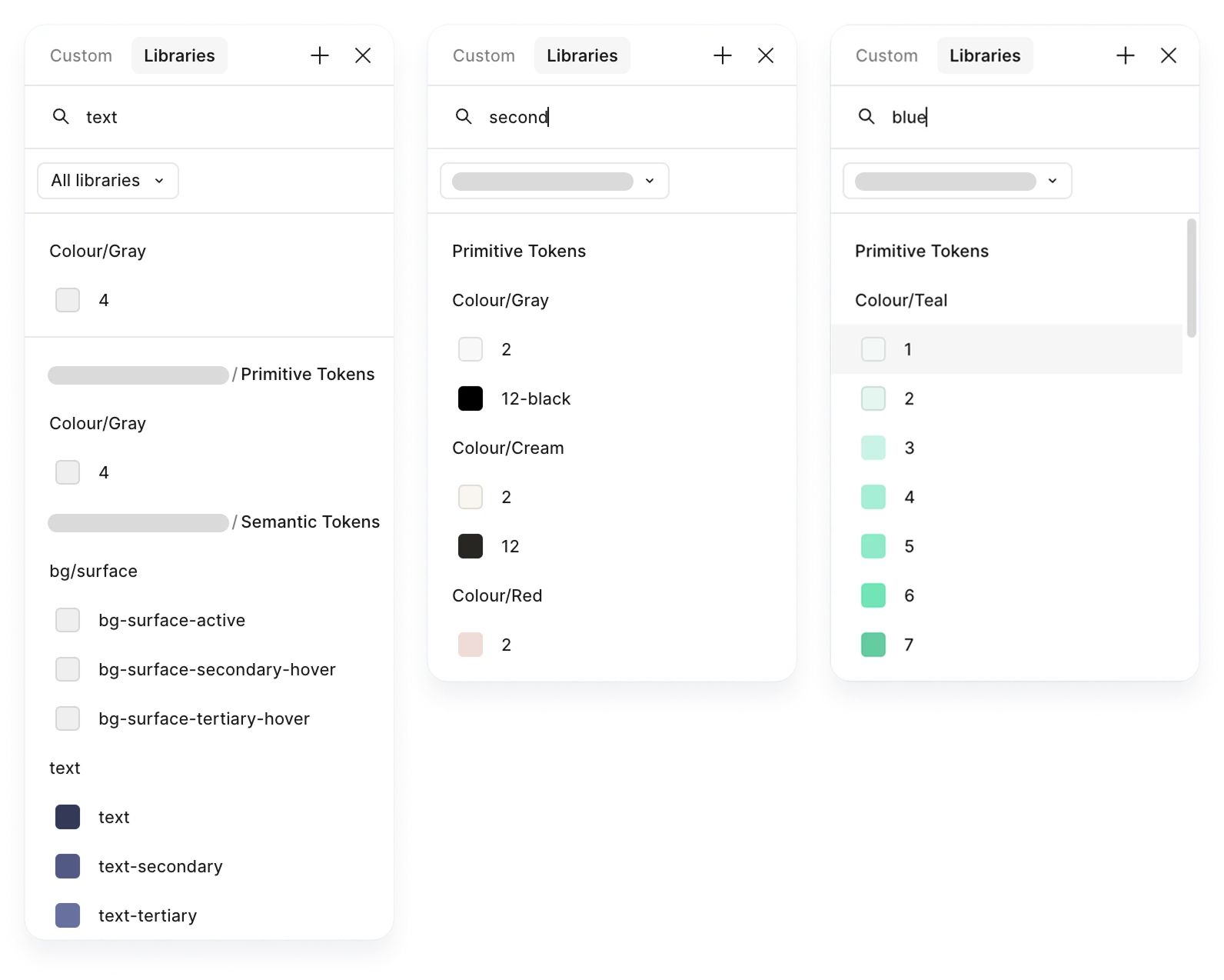

Why is Figma token search prioritizing seemingly irrelevant results over the obvious tokens?
I’m experiencing an new issue with token search where results don’t seem to prioritize relevant matches, particularly when trying to find semantic tokens. This behaviour seemingly out of nowhere, and I haven’t been able to revert it.
When I search within the token menu, the results appear inconsistent and often surface unrelated primitive or semantic tokens ahead of the ones that actually match my query. “Expected” is what was previously appearing for these searches.
Examples:
  • Searching “text”:
    • Expected: text/text
    • Top results: colour/gray/4 (primitive tokens)
    • Then: unrelated semantic tokens like background/surface/active, background/surface/secondary, etc.
    • The expected text semantic token appears as result 4
  • Searching “secondary”:
    • Returns multiple primitive color values (greys, blacks, creams, reds with numeric scales)
      • colour/gray/2 and colour/gray/12
      • colour/cream/2 and ​​​​​​​colour/cream/12
      • ​​​​​​​colour/red/2 and ​​​​​​​colour/red/12
      • etc...
    • Relevant semantic tokens with “secondary” appears
  • Searching “critical”:
    • Shows all shades of red first
    • Tokens labeled “critical” appear afterward
  • Searching “blue”:
    • Returns the entire spectrum of colour/teal before expected matches
Additional context:
  • This happens both when searching across all libraries and within a specific library
  • It applies across multiple keywords, not just one case
  • This behaviour started suddenly (it previously worked as expected)
What I’ve tried:
  • Logging out and back in
  • Reinstalling Figma
  • Using the “Reset Figma and restart” option
None of these resolved the issue.
Question:
Is this expected behaviour for how Figma ranks token search results, or could something be misconfigured on my end? Has anyone found a way to improve or control how results are prioritized?
4 replies
OscarLaliberteElse
Apr 8, 2026 9:10 PM UTC
Here are some screenshot of how these results are displaying:
It seems to be prioritize returning primitive tokens over semantic ones, even if the semantic token matches the search result very closely. However, this still doesn’t explain the search of “Blue” returning Teal>
An help is greatly appreciated! This is driving me crazy!

I am having the same issue, been persisting for the last few days. I had set up my tokens to be able to be found by typing a few characters
e.g. For “color/border/default/subtle” I could type “Bor Su”.
This is no longer working and I now have to scroll through a huge list of tokens to get to the right one.
