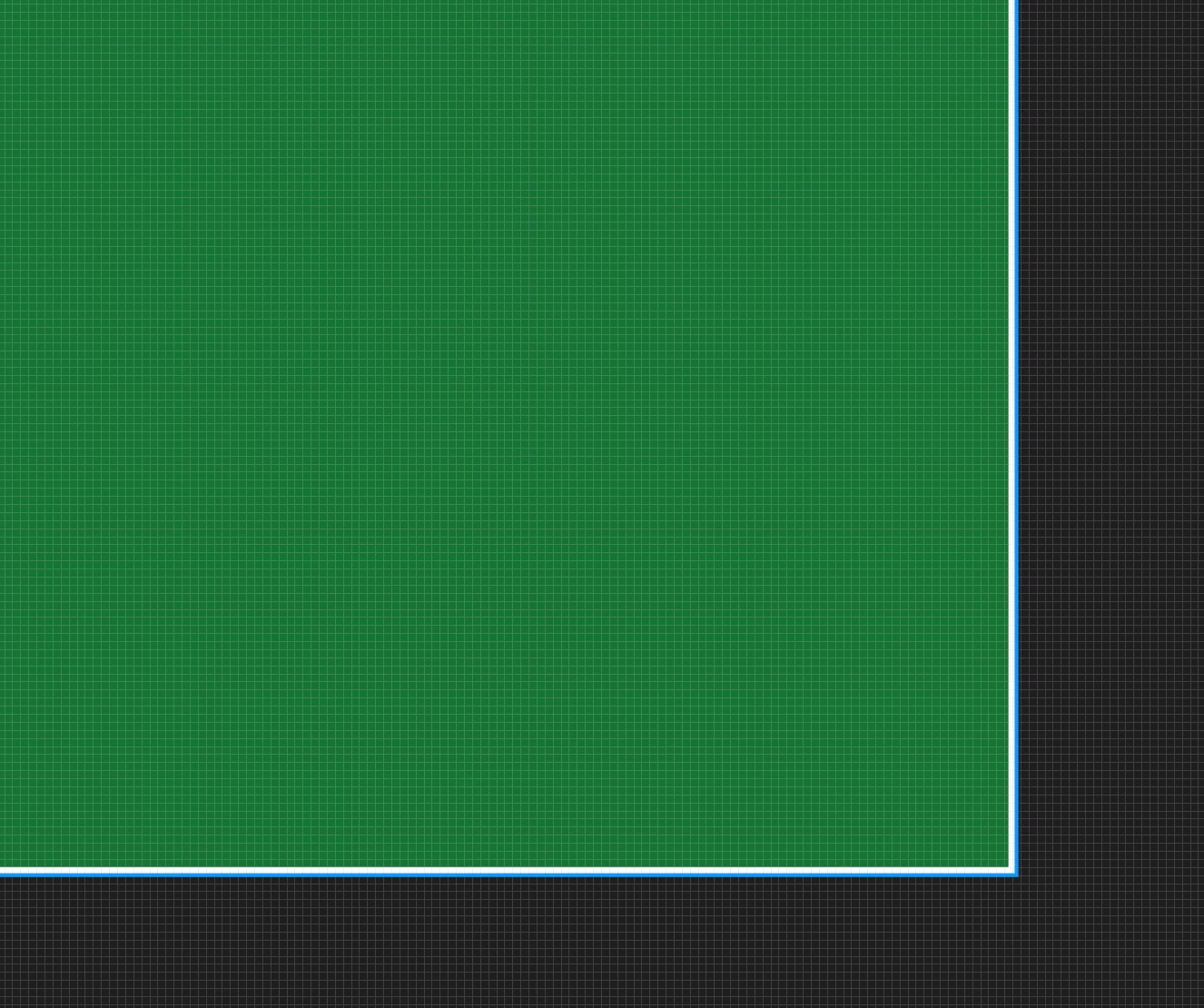

Why is Figma adding and additional 1px white line under and to the right of exports, despite being the artwork being on whole pixel co-ordinates?
When exporting lots of different sized creative assets, Figma occasionally adds an additional 1px horizontal white line below and to the right of exported frames (JPEG) This occurs even if the artwork is on whole pixel x and y co-ordinates?
Our team corrects this issue by scaling down the assets by -0.01 pixels on both dimensions and exports again, but it appears there is a miscalculation occurring on export, and the frames are being exported incorrectly and at a larger size (Additional pixel on both edge)?

Hi ​@Adam Hughes ,
I understand you’re experiencing an issue where exported JPEGs sometimes show an extra 1px white line along the bottom or right edges.
Thanks for confirming that both the X and Y positions of your frames are set to whole pixels.
We’re aware of a similar issue that could occur when an object’s X or Y position includes a decimal value (for example, X: 100.5).
However, our engineering team recently rolled out a fix for this. If your case is related to that cause, please try fully refreshing Figma to see if the issue persists.
Here are a few other possible causes and solutions:
  1. Export scale multiplier
    We’ve observed that this issue can also occur when exporting assets using a non-integer scale multiplier (for example, 0.8x), unless the frame is positioned at (0,0).
    If this applies to your case, try placing the frame at the origin point before exporting as an alternative solution.
  1. Frame dimensions
    In my own testing, I found that a similar issue can happen when the frame’s dimensions include decimal values (for example, H: 100.5).
    If that’s the case on your end, please try setting the dimensions to whole integers instead.
  1. GPU driver
    Additionally, some users have reported that updating their GPU driver resolved similar export artifacts, so you might want to check that as well.
If none of these steps apply or the issue still occurs, we’d recommend submitting a support request through this secure form: Submit a request
When you fill out the form, please include:
  • A short screen recording showing the steps to reproduce the issue
  • The URL of the affected file
  • The exported image file from your test
This will help our team investigate more effectively.
