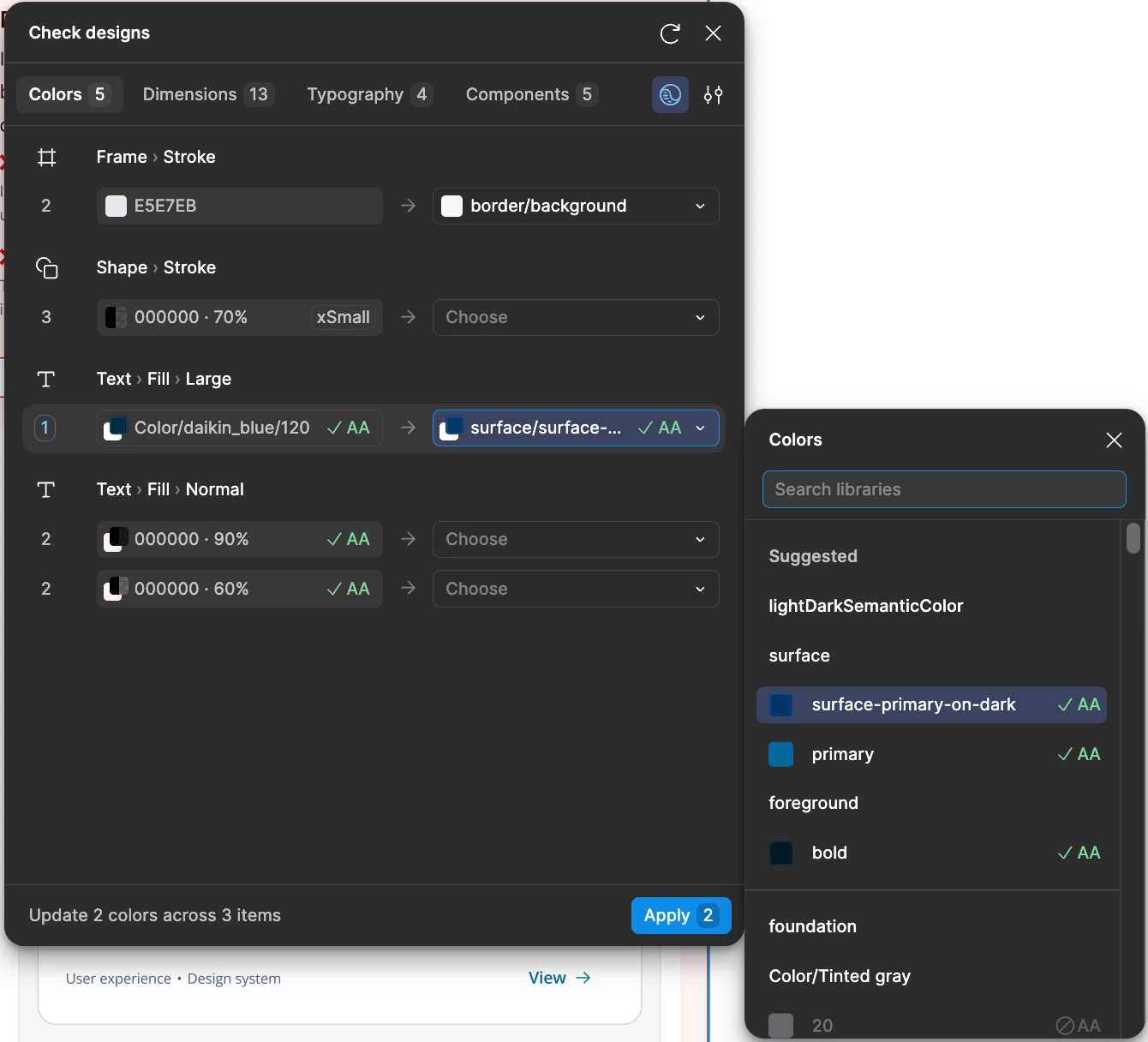

Why is a variable not in the file being suggested in "Check design"
Check design is a great new featured, we’ve all missed applying a style, variable or whatever to our designs, but I’ve noticed even if I only check for the variables and styles created in the current file it will suggest variables that are not in the file form other libraries, anyone running into this issue?

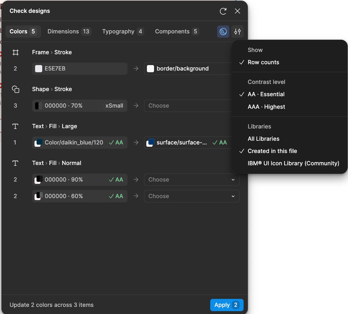

Yeah ,I’ve chosen a specific library I’ve double checked that the variables it’s suggesting aren’t part of said library but they still appear and it kind of defeats the purpose of the feature

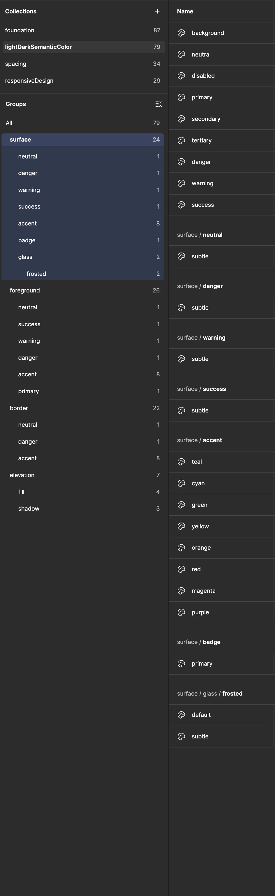

As you can see from my screenshots, I’ve checked created in this file, it’s suggesting surface-primary-on-dark variable, but when I got to my variables it is not a part of the variables in this file

Hey ​@Rob3 Thanks for the detailed follow up.
You've done the right thing by scoping to "Created in this file," so a suggestion for surface-primary-on-dark that isn't in your file's variables shouldn't be showing up under that setting. I created a support ticket for this. The ID 2030882 is and the subject line is Check designs suggests variable not in file when scoped to "Created in this file". If you don’t see it in your gmail inbox, pease double-check your spam folders (Gmail can be a bit aggressive with support tickets) Thanks again 🙌 — Jaycee
