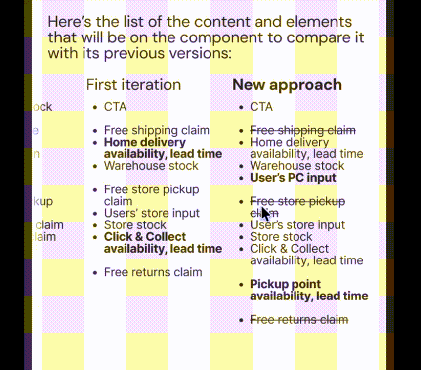

I’ve a frame where I need the content to be right aligned while the content overflows his parent:
This has to be the sorting order of the bullet points columns, as previously it’s been also shown like this.
In Figma Sites, this doesn’t work. Whereas when aligning the child to the left, it does work.

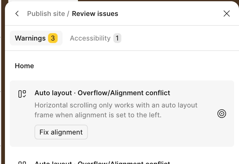

In fact, when you try it you get this error when trying to publish:
Error on the publishing panel

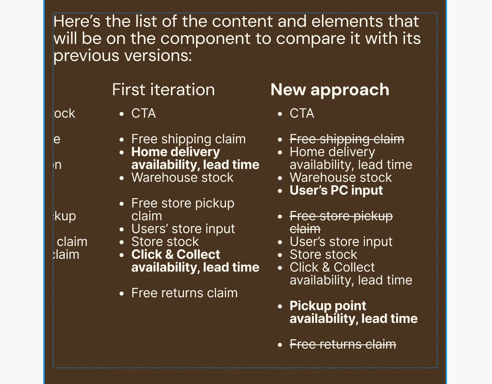

However, on Figma Design you can do this and even prototype it and it works!!!
