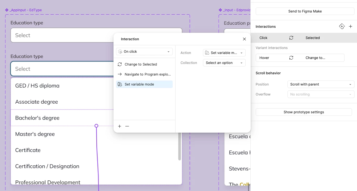

No matter how many times I tried to copy / paste (Command-C, Command-V) from the blue left side of the interaction, or the purple arrow, the interaction would not copy, and will only paste a text or image that was copied prior to that. Best I could do was copy the whole component variant and paste that in, then modify the interactions.
HOWEVER, I just tried copying and pasting simple interactions between other simpler components and it worked! Then tried to copy and paste more complex interactions from one component to another, and those worked too, but the original component I was trying to copy interactions from still wouldn’t copy, though I could paste the interactions from the other, simpler components.
So then I deleted the original complex interaction that wouldn’t copy, re-created it from scratch, and it copied and pasted to other components! My guess is I’d modified the order of the interactions so much, that particular component’s interactions got corrupted and wouldn’t copy at all. Deleting and recreating the interactions reset the corruption…?
However, I’m now seeing that my pasted ‘Set variable mode’ interaction is not sticking, so I have to assign a mode and value for each time I paste it. Still not ideal, but a bit better.
