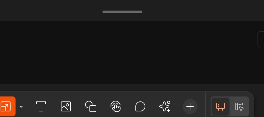

Why button measurments doesnt work
Hi! Why after installing a new version and after subscribing to collab mode the button (right one with rulers) doesnt work in design mode?
Junko3Solution
Oct 20, 2025 2:04 AM UTC
Hi ​@Варвара Сафронова ,
It looks like you’re opening a slides deck and are having trouble toggling to Design mode.
As mentioned in this article, “Collab” seats don’t include access to Design mode in Figma Slides. Manage seats in Figma
If you have a Full seat and edit access to the slide deck, you’ll be able to enable Design mode. You can learn more here: Use Design mode in Figma Slides
