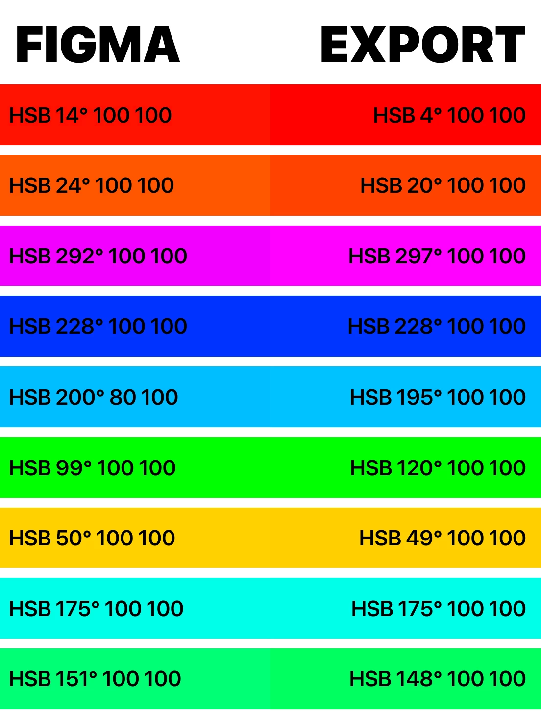

Hello,

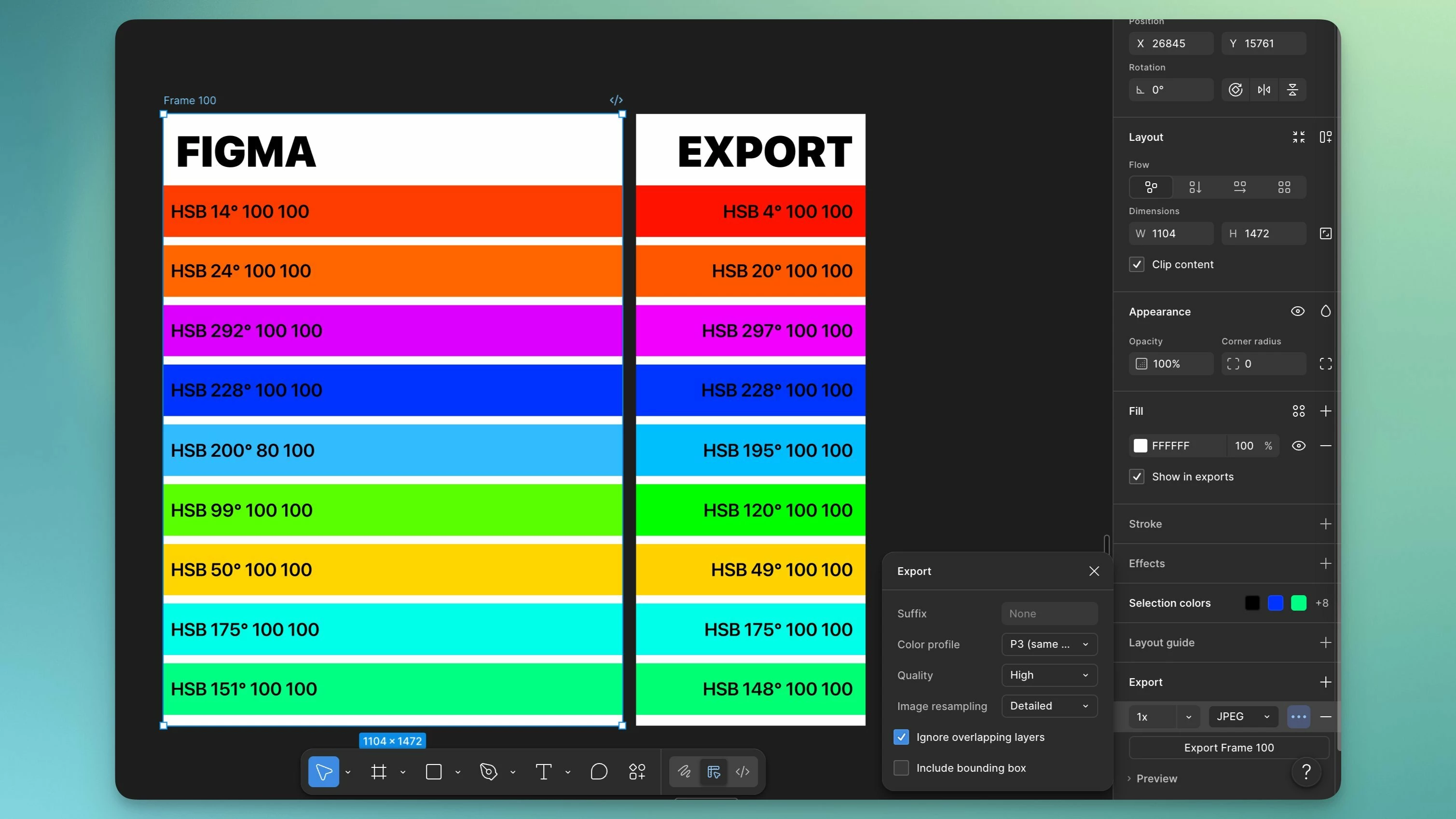

My Figma file color profile is set to "Assign to Display P3". The export color profile is set to "P3 (same as file)".
But when I export a frame (JPEG or PNG), some colors don't match between the original Figma frame and the exported file (see HSB values from Figma).
Any idea why? And how I could get the exact same colors?
Thank you,
Axel

Hi ​@alpennec, thanks for flagging this on X!
To close the loop and help anyone else running into the same issue, this usually happens due to JPEG compression. You can fix this by changing the document color profile to sRGB in preferences and setting the explicit export profile to sRGB as well. This should stop color desaturation or shifting for your JPEGs.
If you have any further questions, please let me know.
