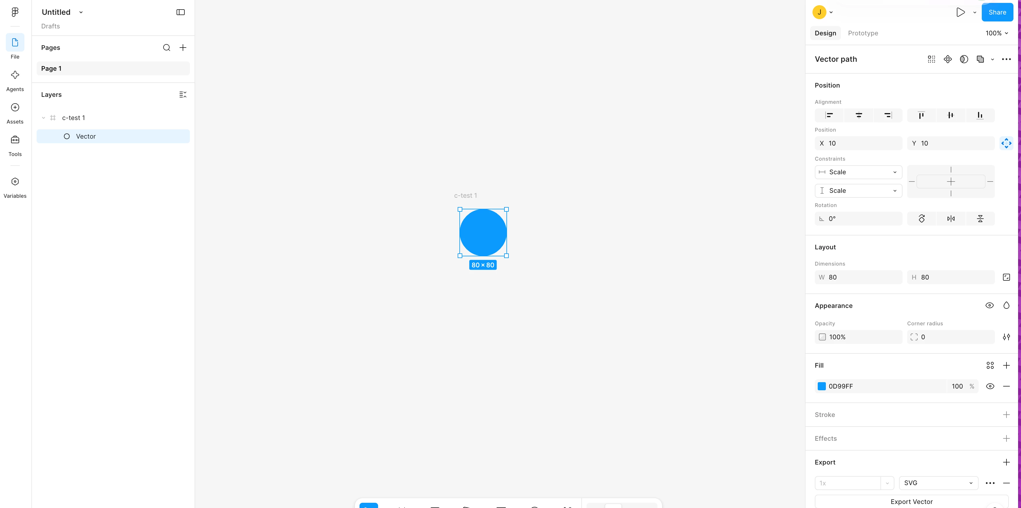

Hey ​@Brian_Olson 👋 Thanks for flagging this. I made a quick test to see if I could reproduce what you're describing.
Here's my source SVG:
<svg xmlns="http://www.w3.org/2000/svg" width="100" height="100" viewBox="0 0 100 100">
  <circle cx="50" cy="50" r="40" fill="#0d99ff"/>
</svg>
It appears the <circle> is coming back out as a <path> (with Bézier curves approximating the arc) — same shape, different element type. Does this match what you're running into on your end?
If so, I can check with our internal resources to verify whether this is working-as-designed or something worth flagging — and if it's expected, I'll get a feature request logged for preserving primitive shapes on import/export. Just want to make sure my repro lines up with yours first! Thank you! — Jaycee

Hi ​@Jaycee Lewis, yes! That’s exactly the problem that causes me so much headache and lost time.
Thank you! I would be so happy if Figma can be fixed to preserve primitive shapes on import/export! This loses me so much time!
