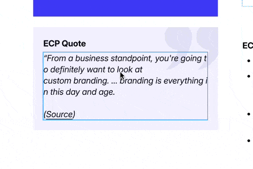

Text weirdly breaks within words when scaling a textfield. It’s plain text with no editing or line breaks, however text breaks within words or lines.
Anyone else having this problem?

I have had this problem as well. I am having this problem with text copied from Vidlet. Copying into another program does not strip this strange breaking behavior.

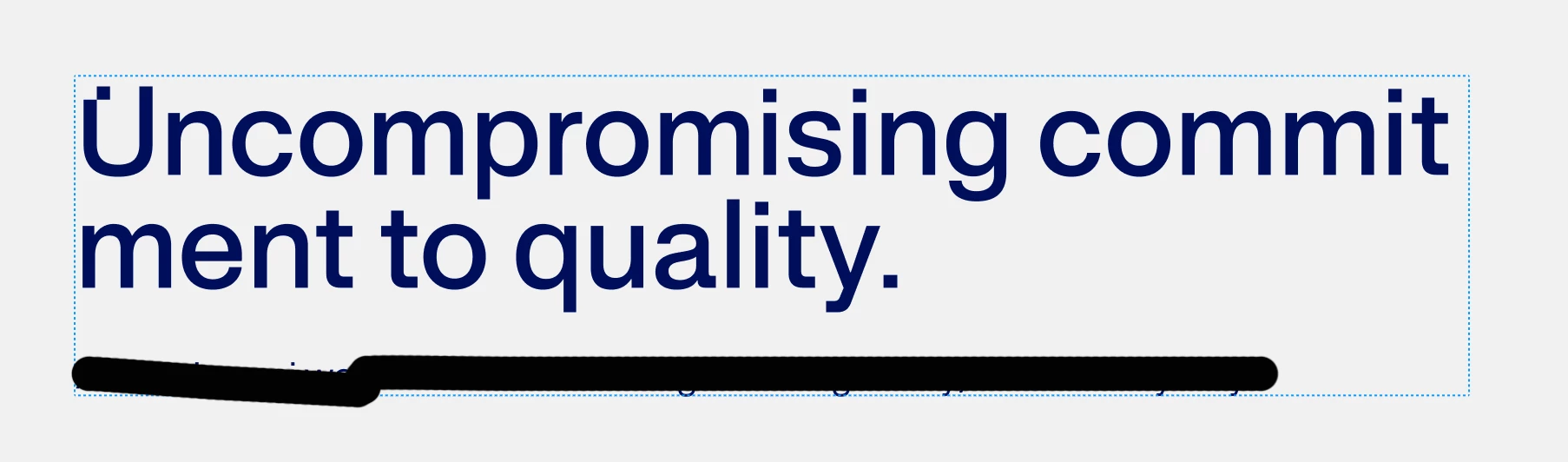

Same problem, random word or letter breaks all over the place. Commitment should break the whole word, not the letters.

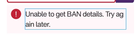

Same issue here! Happens when I copy/paste text from Jira. Tried copy / paste, paste as text, copy as text, pasting text in different apps in an attempt to strip off any formatting. Only solution I found was to type out text by hand. :(

same problem here - words breaking across lines. Doesn’t matter if paste from a source with all formatting stripped

For ​@Sara McLachlan , after checking with our Technical Quality team, it appears the issue in your file is caused by a non-breaking space in this location. This may have been copied from somewhere, or accidentally entered (on macOS, it can be typed with Option + Space). Because of this character, the wrapping you’re seeing is expected behavior.
You should be able to resolve it by replacing the problematic space with regular space. Please reply directly to your support ticket, the team is currently waiting for your response.
For anyone else following this thread, please try checking for non-breaking spaces as well.
