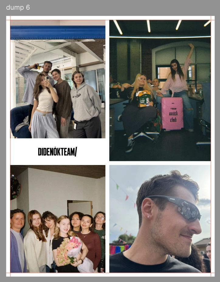

Me and my colleague have both recently experienced the same issue — when exporting frames as png/jpeg, some random images within the frame are cropped and zoomed in, not in a way they appear on the canvas. All images are rectangles with a photo fill set to crop yet only some of them do this when exported. If you copy the frame as png, everything is fine, and the issue persists only when exporting

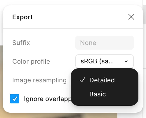

  3. In the Export section, open Advanced export settings and check Image resampling — it'll be on Detailed by default. Does switching it to Basic change what comes out?
    Advanced export settings.
