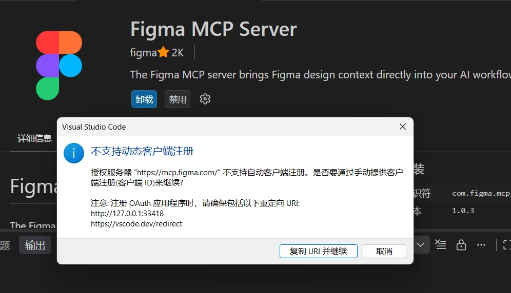

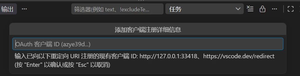

Jackson Zhang
Oct 15, 2026 8:05 AM UTC
I have same question,when i want to initiate figma mcp server A pop-up appeared, asking me to add client registration details.(Quth Client)It won't start up properly; what should I do?

Jackson Zhang
Oct 16, 2026 2:36 AM UTC
Hi , I was using the latest version of VS Code,I was going through the standard MCP server installation process when a "Dynamic client registration not supported" error popped up, immediately followed by a window prompting me to provide client registration details. I’ve tried uninstalling and reinstalling multiple times, but I can’t find a solution—I’m stuck at the initial authentication step.
