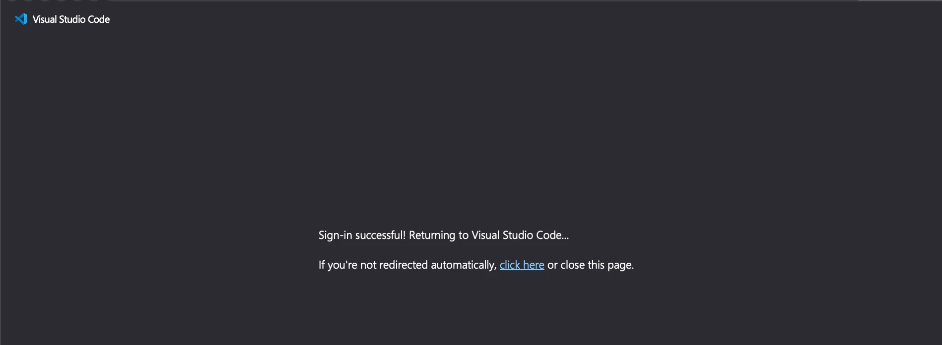

and start the server in VS Code, a browser opens to https://www.figma.com/oauth/mcp/... where I click “Agree and Allow Access”.
It seems that fails then a window in VS Code shows “You have not yet finished authenticating to 'Figma MCP'. Would you like to try a different way? (URL Handler)”, which I click “yes” and it takes me through the same Figma OAuth Access flow in the browser, and re-opens VS Code.

When I click the Start Server, and a browser window was opened, I clicked the Agree & Allow Access.
It says sign-in successful, but when back to VS code, it says no,
I tried yes, but still not work.
