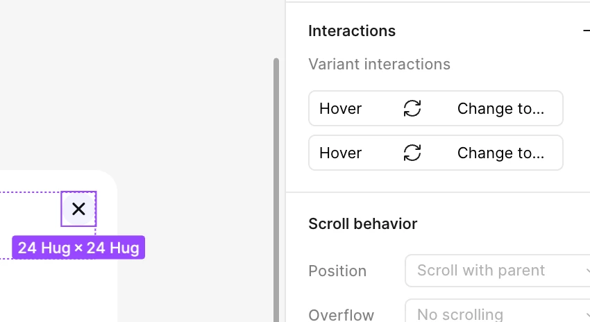

Alexander Tengner
May 20, 2026 11:15 AM UTC
Her is an example of when an interaction gets added. I changed the size of the button from Medium to small and the hover interaction from the medium button stays and stacks on top of the interaction from the small variant of the button.
