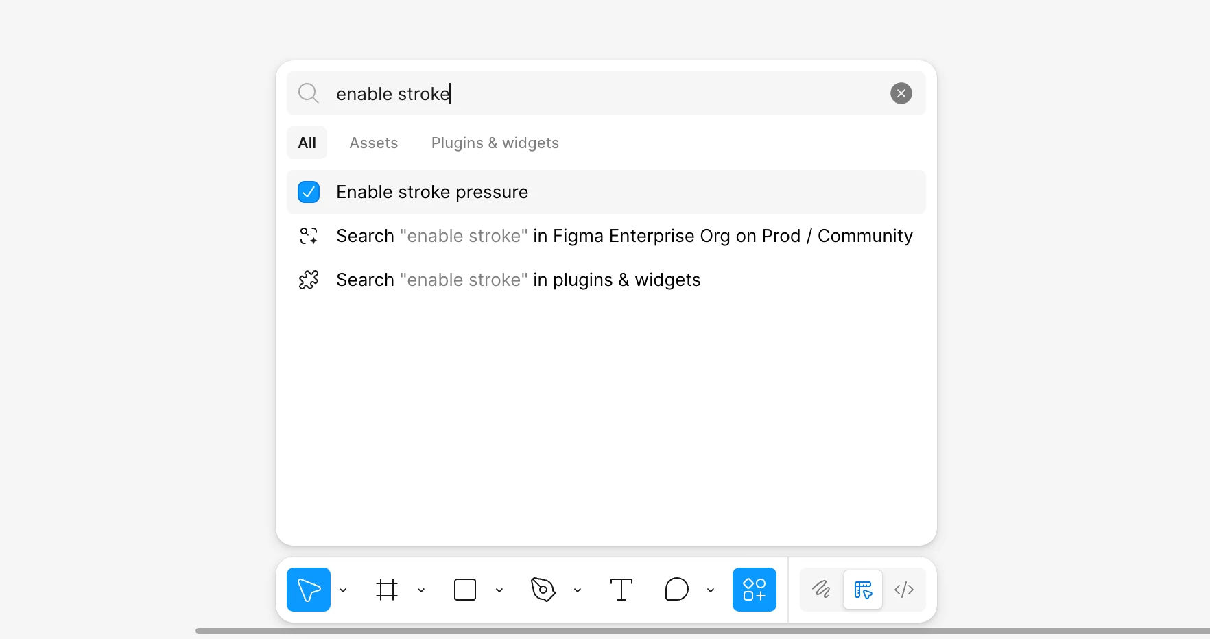

Same issue 2 here. It would be so simple to just have a checkbox in figma that 'disable wacom's pressure' and that would be solved :(
elisaluan
February 17, 2026
​@Bruno_Ponzini1 We have a quick action option to disable pressure sensitivity, see “Enable stroke pressure”

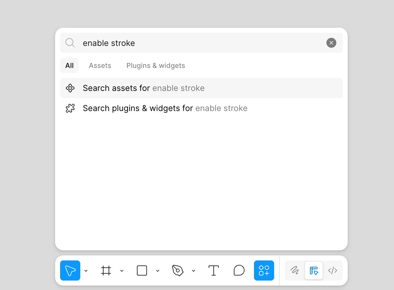

Bruno_Ponzini1
February 17, 2026
​@elisaluan that sounds great! But i tried to find here and couldn't find, i tried both the Mac OS app and chrome page. Is there something i need to do to make it appear? Thanks again!
elisaluan
February 17, 2026
​@Bruno_Ponzini1 Are you in Figma design or FigJam? It should just appear in the QA menu (cmd + /)
Bruno_Ponzini1
February 17, 2026
​@elisaluan  Figma Design!
I also checked for updates and there  is nothing. So weird.
elisaluan
February 24, 2026
Following up here that this issue is now fixed and “Enable stroke pressure” should appear for all users!
