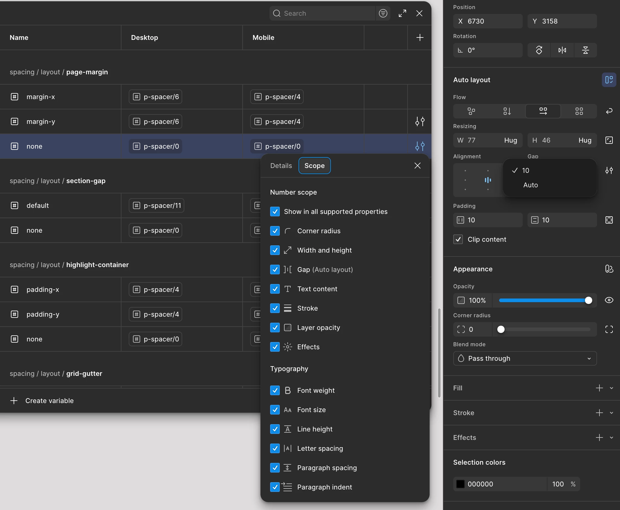

Please help, i can’t find my “apply variable” or the “variable” control at all, even though i’ve applied the variable scope to every possible numeric value. This is the worst update ever!! Can you please revert it back to how it was before?? I can’t work like this!!
Celyn_L
Celyn_LSolution
Aug 25, 2026 3:09 AM UTC
Hi everyone, Celyn here stepping in for ​@adamsmasher. Thanks for taking the time to share your feedback.
One possible reason the Apply variable controls aren’t appearing is that you may currently be in Draw mode.
Could you try switching back to Design mode and let us know whether the controls reappear?
