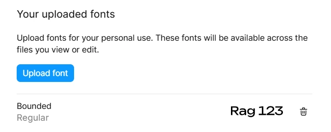

    Nellya
    Power Member
    Oct 31, 2026 8:45 AM UTC
    You probably can use custom fonts on your iPad. Try to manually upload them in your account:
    Go to main page (file browser) → Open the menu on left top corner → Settings → Your uploaded fonts → Upload font
