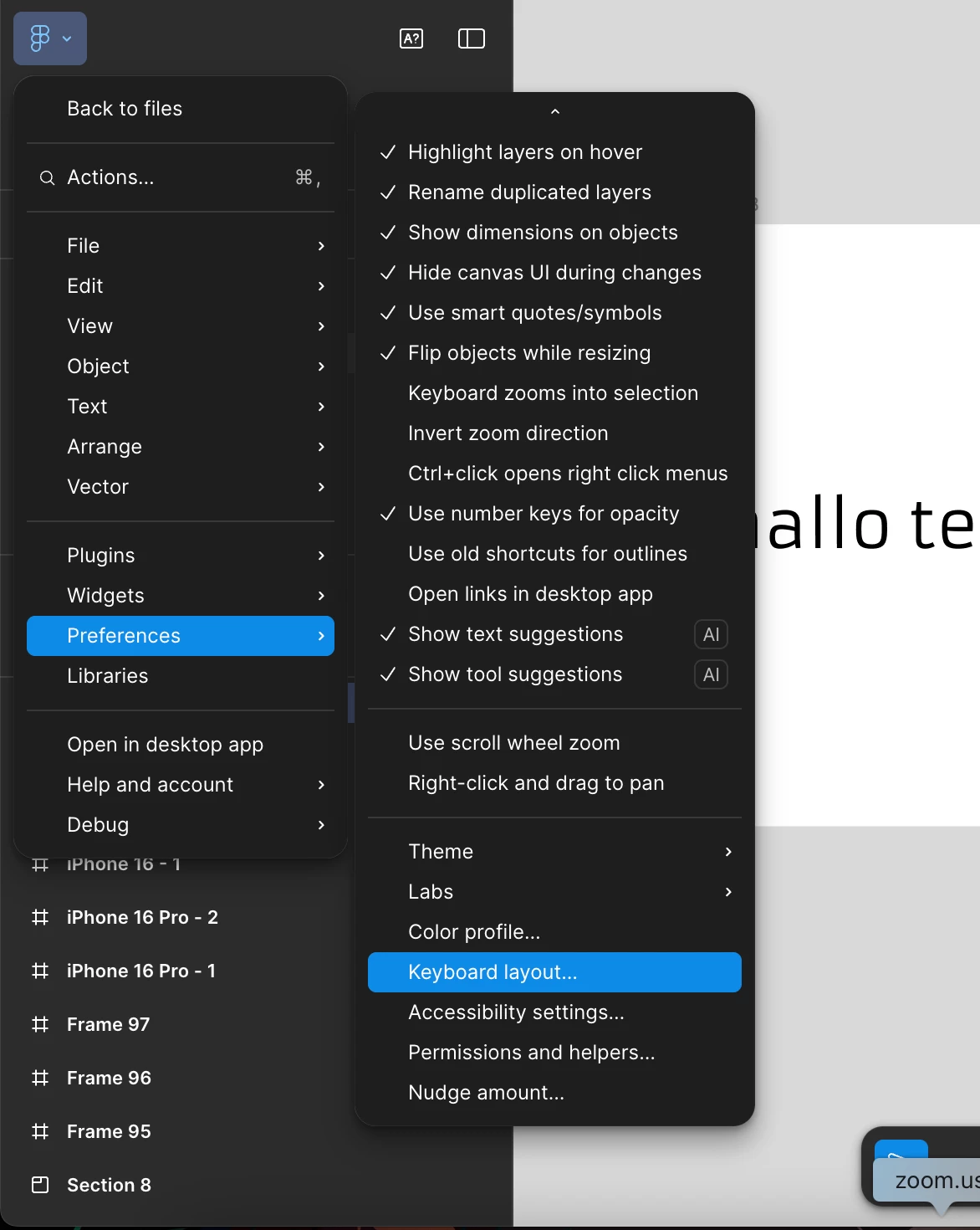

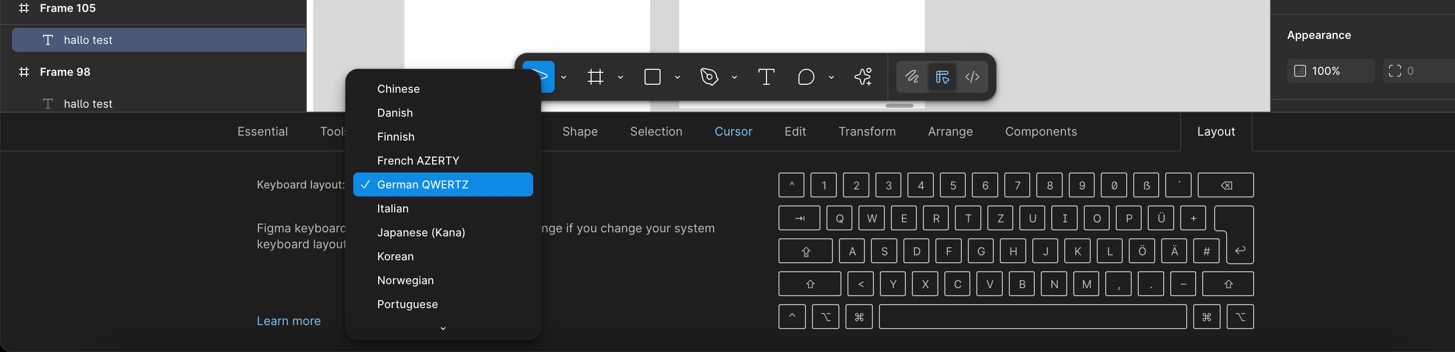

    Also, since you mentioned you’re using a MacBook keyboard, please check your keyboard layout settings in Figma. If these don’t match your system layout, it can sometimes interfere with shortcuts like Command + Z.
    Here’s how to check:
    1. Go to the main menu in your file (click the Figma logo in the top-left corner).
    2. Select Preferences -> Change Keyboard Layout.
    3. Choose U.S. QWERTY or whichever layout matches your Mac’s system keyboard. Find more info in our Help Center article: Select keyboard layout
