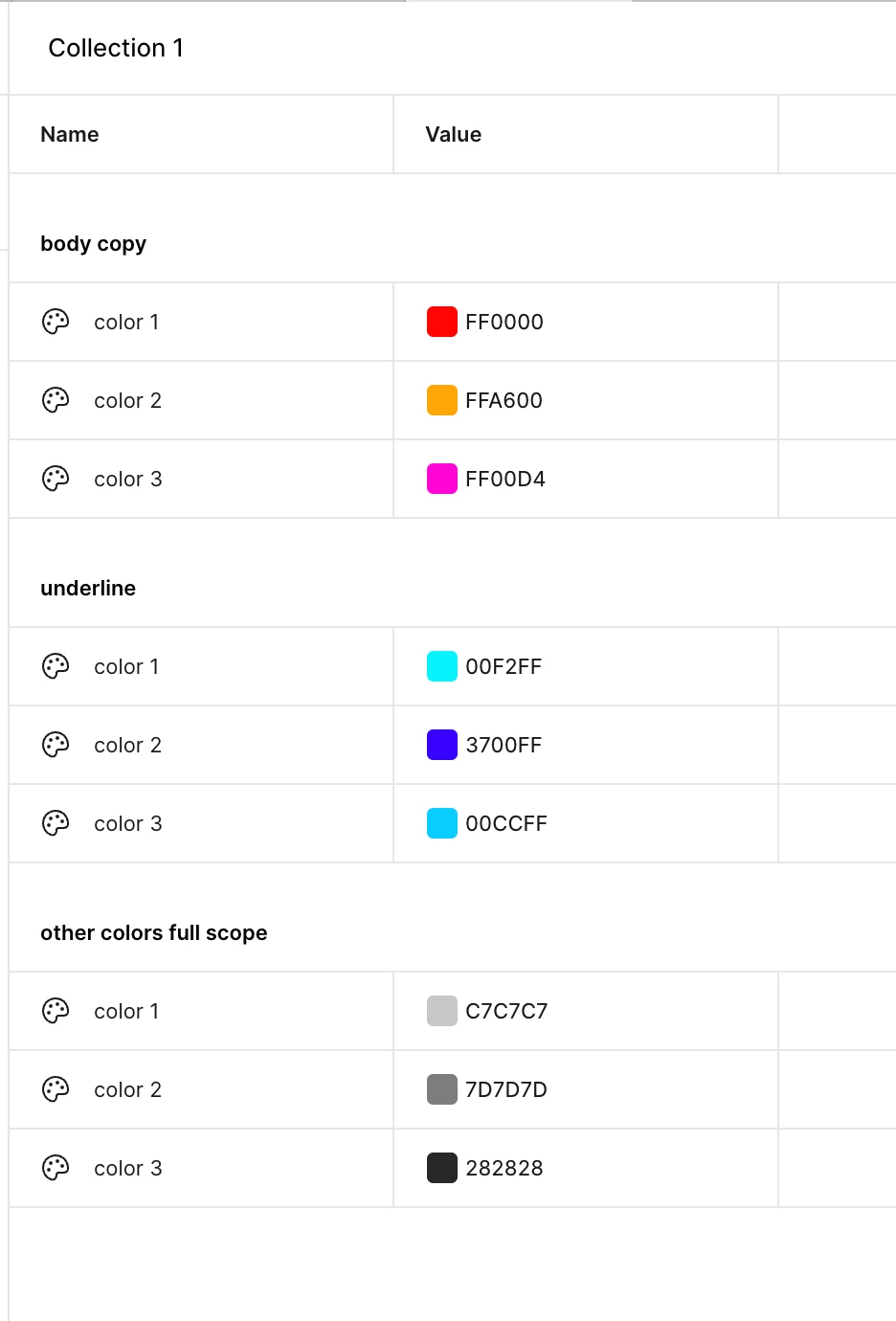

So I’ve just created a brand new file with 3 variable sets, all in the same collection and mode. Body copy and underline variables scopes set to text only. Other colors full scope group set to all properties in scope.

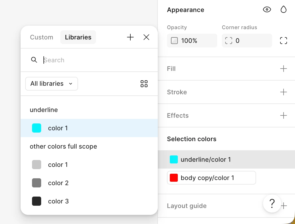

Same issue - the only variables that appear in the selection colors list are the one in use plus other full scope variables, no text only scope.

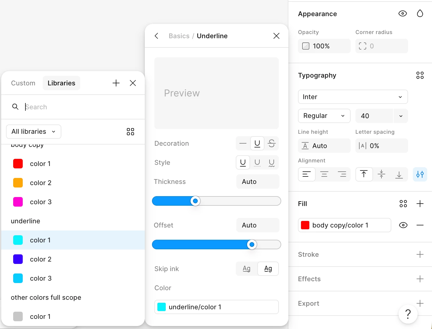

All relevant text only scope variables only appear when editing in the underline type settings
Additionally, I noticed the copy and underline variables only show up in the Selection colours when the text layer is in a frame or a group.
