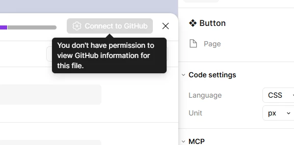

We have organization plan, i am file owner and have full seat. But i am not able to use Connect Code.
I see error: “You do not have permission to view GitHub information for this file” and icon “Connect to GitHub” is disabled:
My organization admin have this button. I asked him to connect our GitHub repository - it was succeeded, but i am still not able to connect any component.

Hi ​@Andrey FRB,
I understand you're seeing the message “You do not have permission to view GitHub information for this file.” The “Connect to GitHub” button is disabled, and you’re unable to connect any components.
I’ve checked internally, and it appears the current requirements for this feature may include the following:
  • Plans: Organization and Enterprise plans
  • Account type: Member or Admin (not Guests)
  • Seat type: Full or Dev
  • Permissions: Can edit the file
Looking at our backend, I see you have a Full seat on an Organization plan, but your account is set as a Guest. This might be why you're experiencing this, as Guests have certain limitations.
