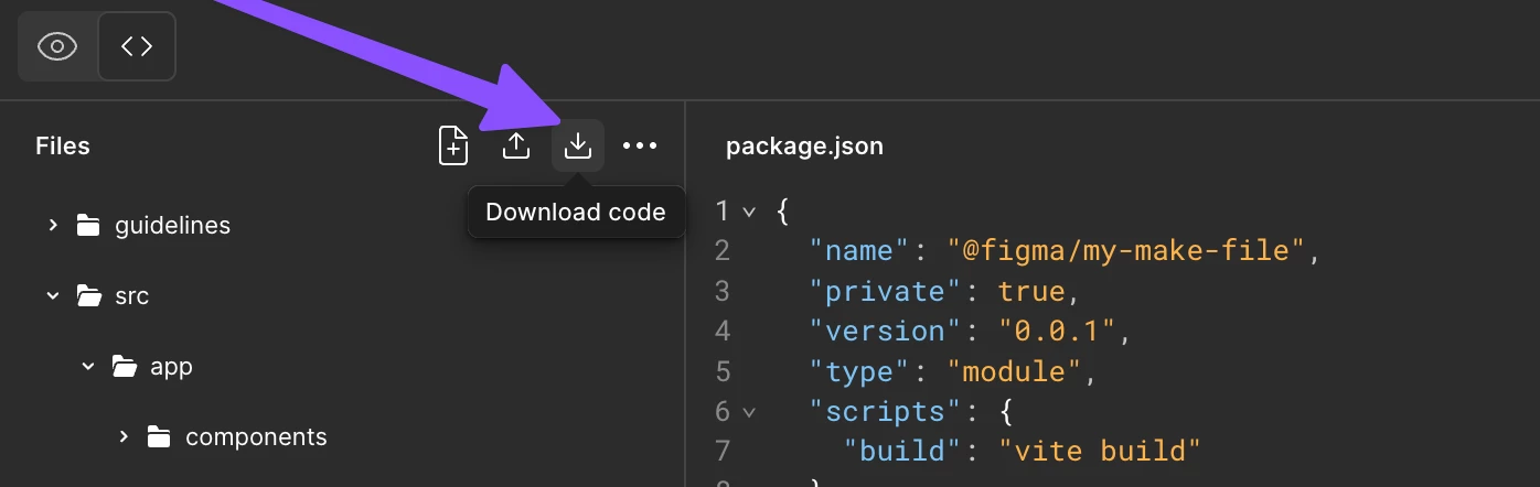

Download as a .zip

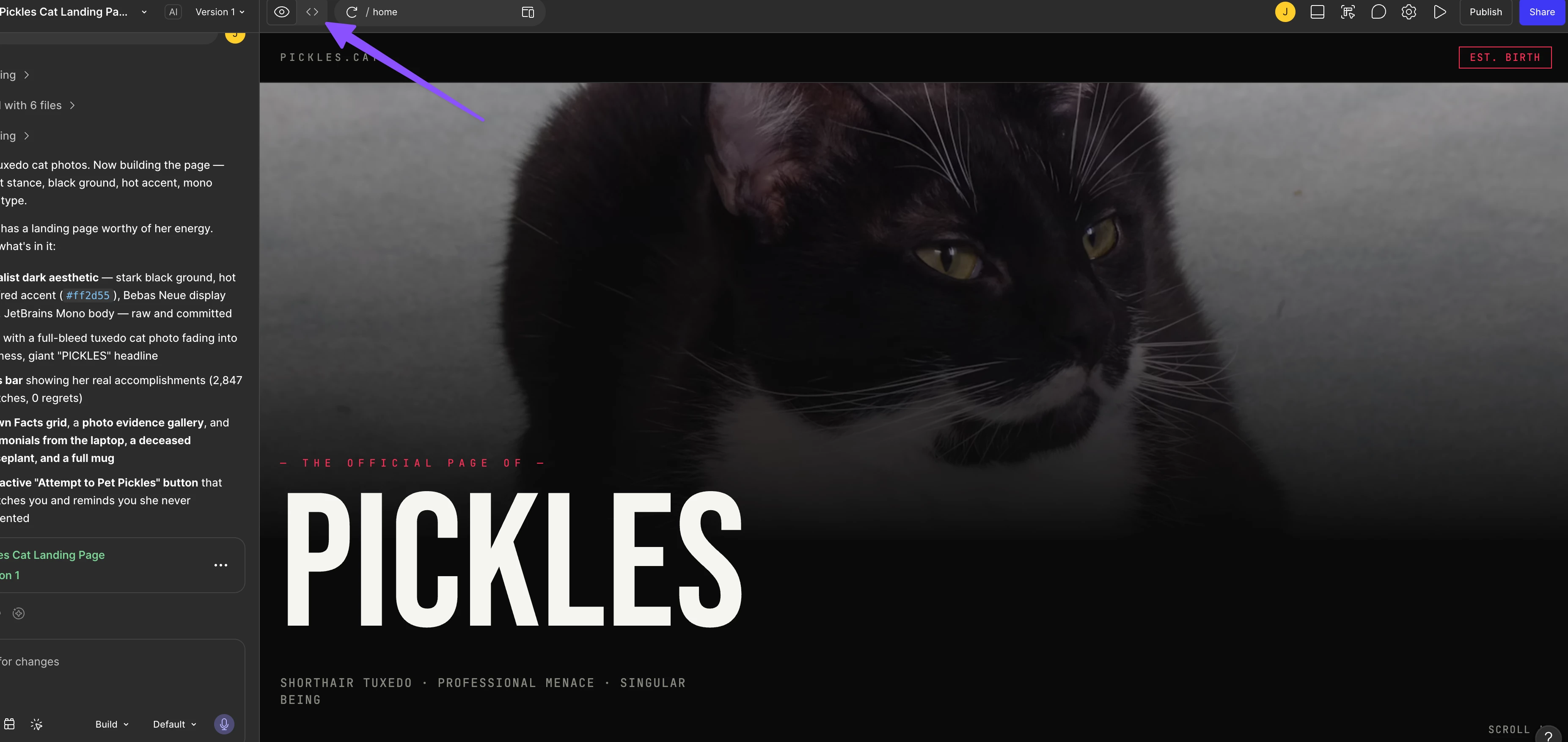

  • Click the </> (Code) button in the top bar of your Make file, next to the preview (eye) icon, to open the code editor
  • In the Files panel header (left side), click the download arrow — its tooltip reads Download code
  • You'll get a .zip of the full project. Double-click to unzip (or run unzip <filename>.zip). One note: use that instead of the tar -xzf command — tar is for .tar.gz, not .zip. After unzipping, the npm install / npm run build steps are correct, and you can deploy to Netlify, Vercel, or your own host

A quick check would help: open the Code editor and let me know whether you see the Download code arrow, and whether it's active. If yes, you're all set; if it's greyed out, we'll know more about the issue
