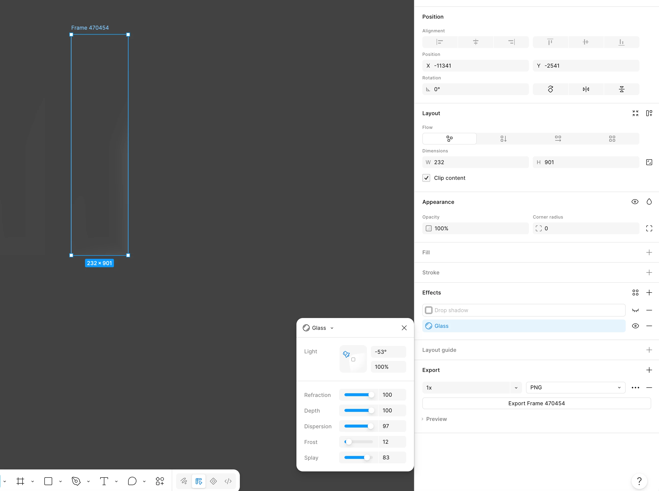

August 10, 2026
I have the same issue. I export the frame with glass effect, it become a white png, and when i use my cursor agent to build code, it becomes just background blur effect.
Jaycee Lewis
August 10, 2026
Hi ​@Slowly 👋 I wonder if we have two seperate issues here.
On the white PNG: could you share a screenshot of the Fill and Effects panels for that frame? One thing worth checking while you're in there: applying a glass effect automatically drops the layer's fill opacity to 20%, so if the frame's fill is white, a mostly-white export can be the expected result rather than a bug.

Slowly
August 11, 2026

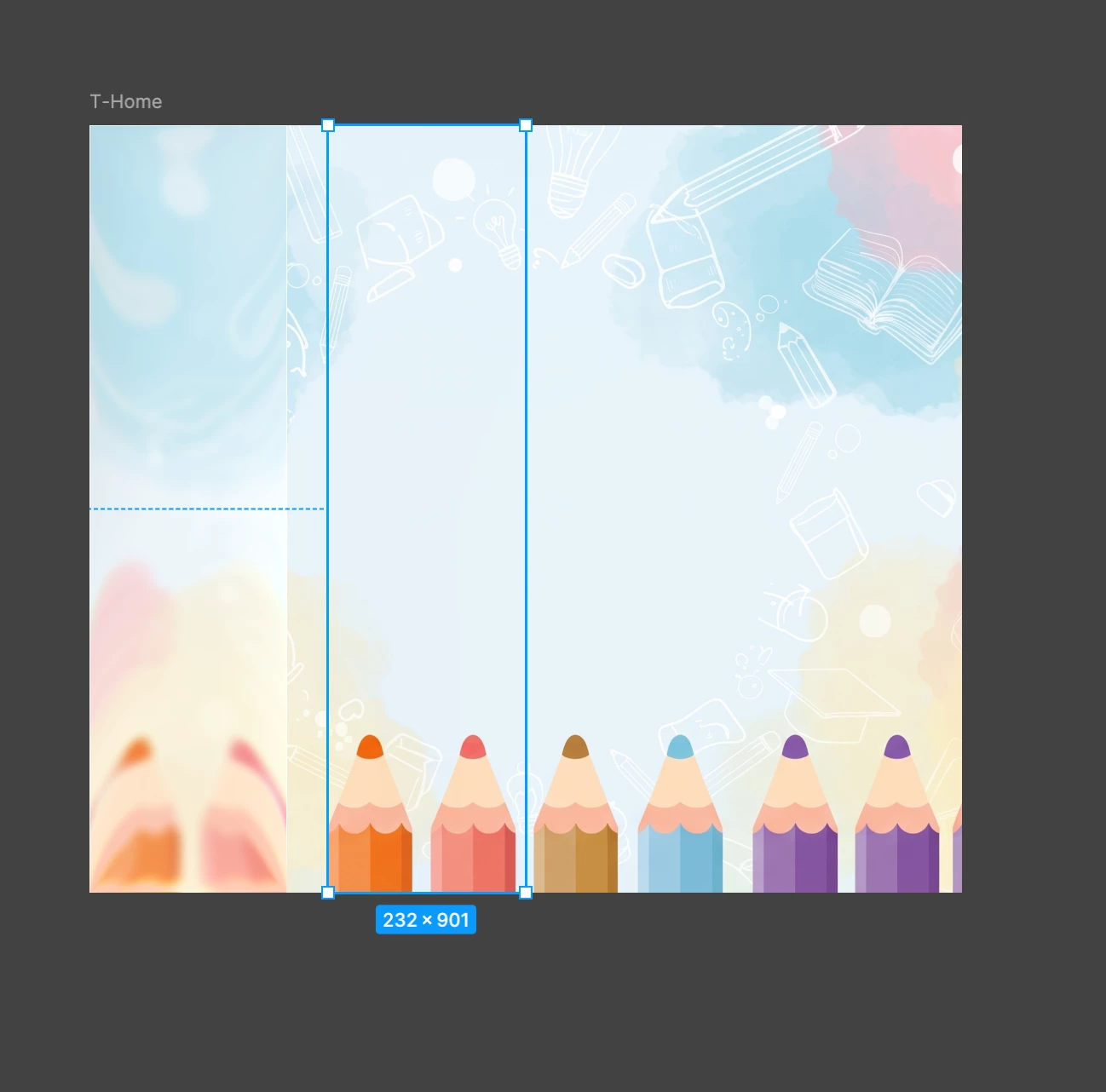

Hi ​@Jaycee Lewis, thank you for your quick reply. I’ve attached a few screenshots of my frame. It’s a design file, but the frame has no elements or fill color. When I export the frame as an image and then re-import it into Figma, nothing appears on it.
On the left is my original Figma design, while the right shows the selected exported image.

Jaycee Lewis
August 11, 2026
Hey ​@Slowly 👋
Glass doesn't have any pixels of its own. It works like a lens, bending whatever sits beneath it.
Try this: select the background and the glass frame together and export the selection — or just export the parent T-Home frame. The glass should come through.
One heads up: there's no way to export glass on its own over transparency, since it needs something behind it to render. If that's what you're after, I'd love to pass it along as a feature request — you're not the first to ask.
