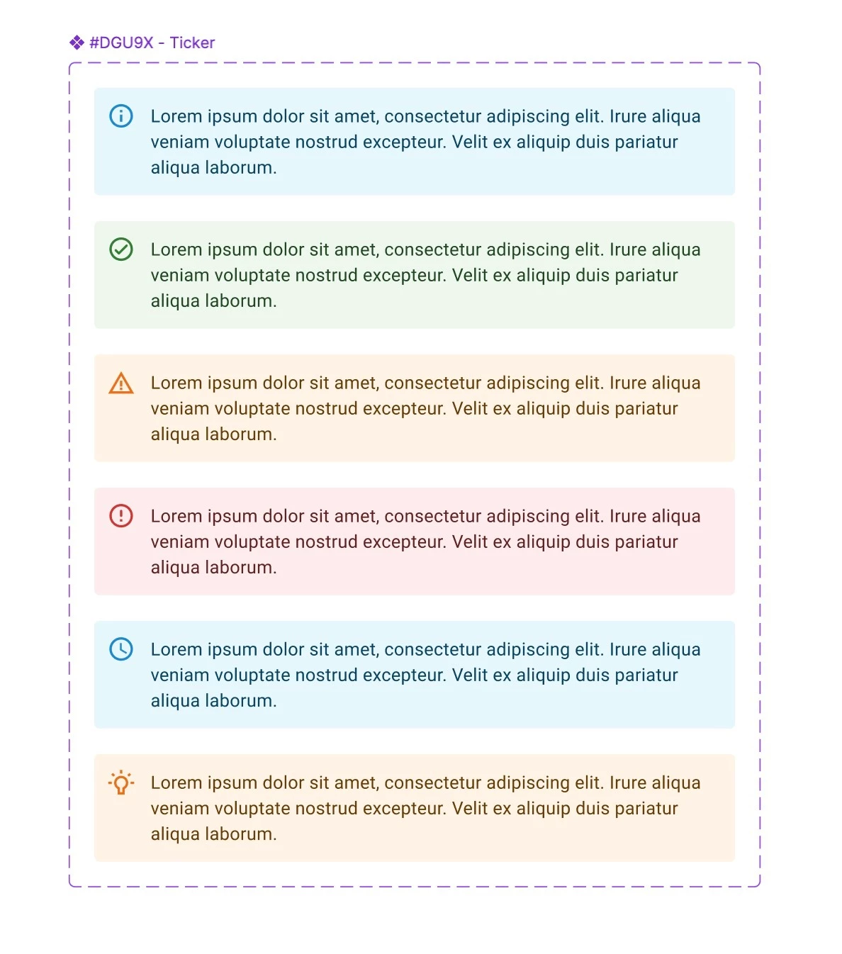

This is the latest version of my ticker component, with variant:
- Info
- Success
- Warning
- Error
- Waiting
- Tip

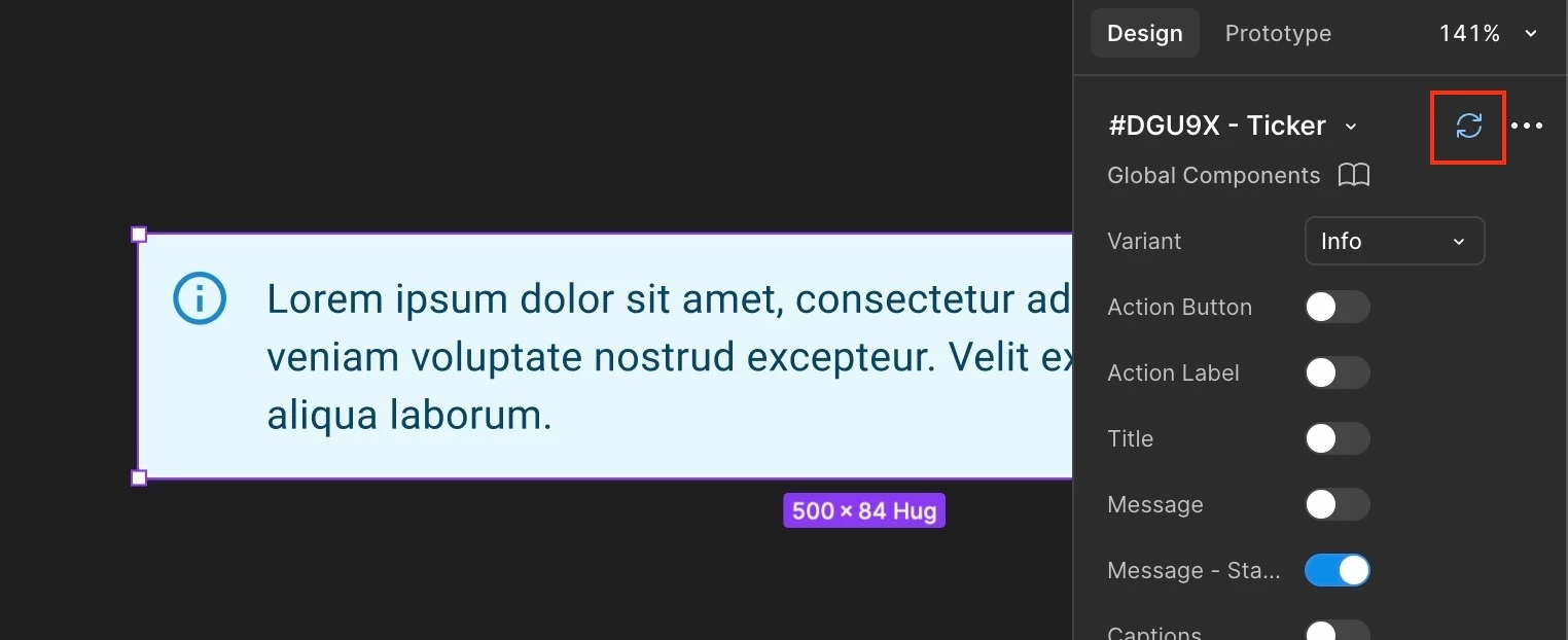

But if I copy that component (as intance) to other page, like this:
As you can see in the picture above, the update icon in the top right corner is active (blue), which shouldn’t be. Because the instance has just been newly copied here using the latest instance directly from the source.

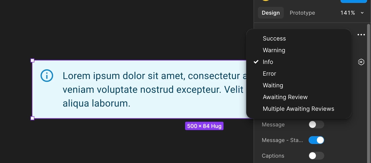

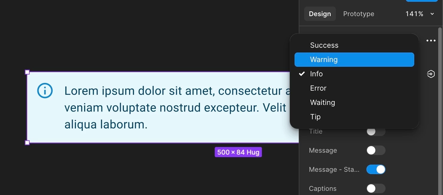

If I open the “Variant” options, it still correctly shows the variant list which is the latest variant list:
But if I update the component by clicking the update icon, it reverts to old version (as depicted in screenshot below) where:
- There was no “Tip” variant that should exist in the latet version
- There was “Awaiting Review” variant, which has been removed in the latest version
- There was “Multiple Awaiting Reviews” variant, which has been removed in the latest version

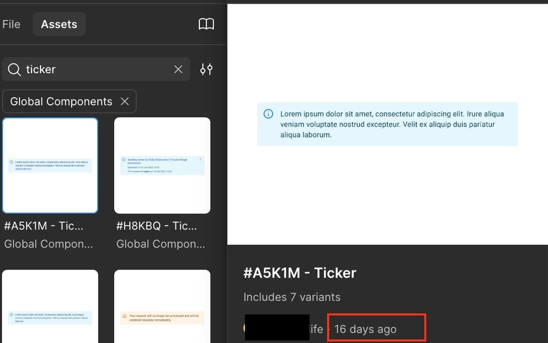

I also noticed something wrong in the component when I tried importing the component from “assets” in the left sidebar instead of copy-pasting: the latest update was “16 days ago”? I just published the update like several minutes ago.
Then I tried removing the file in the assets list, and readded it again. And the issue persists. Seems like… the issue is, the component update is not admitted?
Yeah this does sound strange -- I’m not quite sure why the audit shows the update being so far off, and unfortunately, I’m not equipped with the tools to see more than the surface-level information you’ve screenshotted and provided here.
