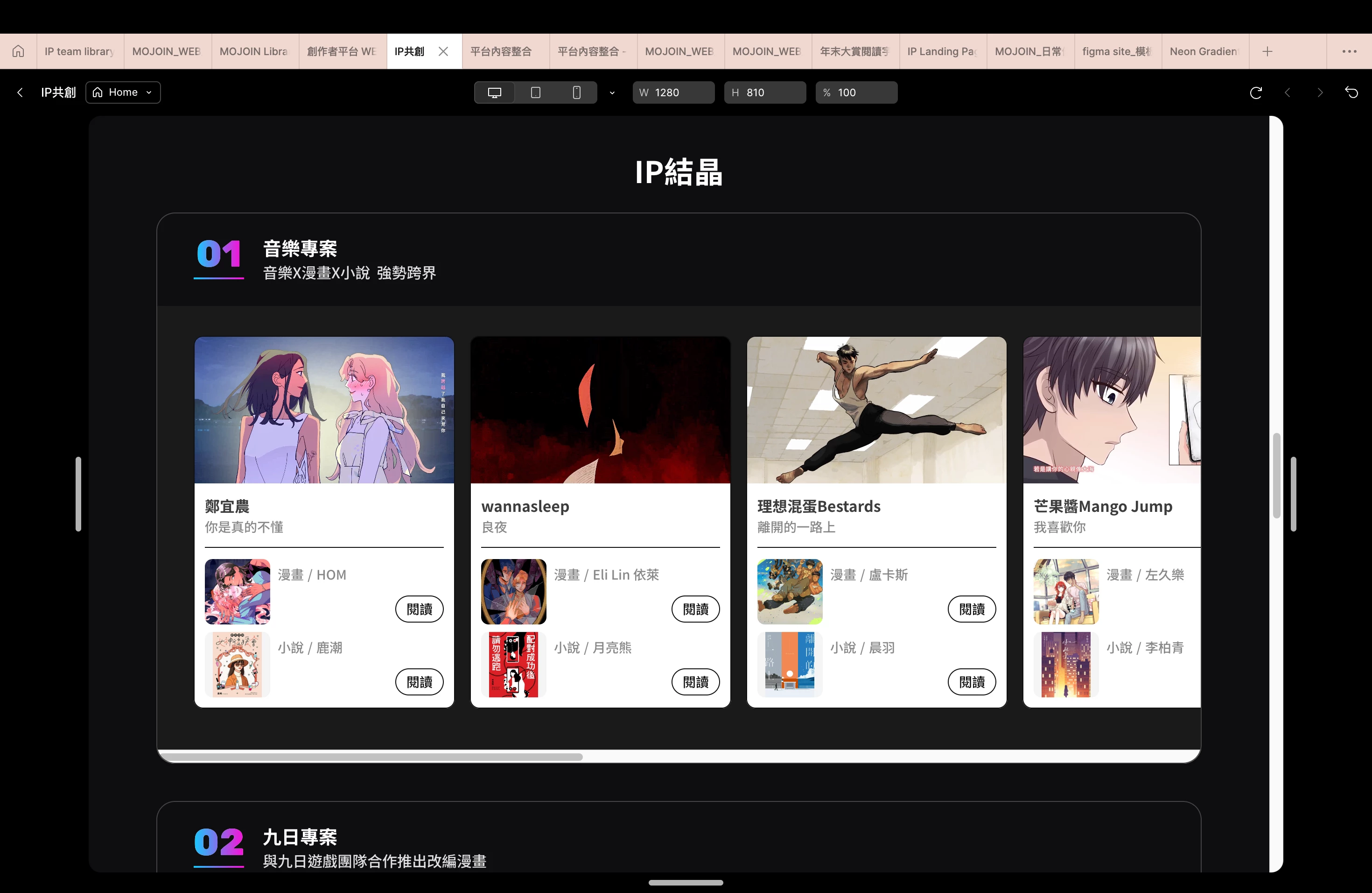

1.In the preview, the horizontal scrolling effect is normal, and the scrollbar appears and can be swiped horizontally.
the horizontal scrollbar appear in preview

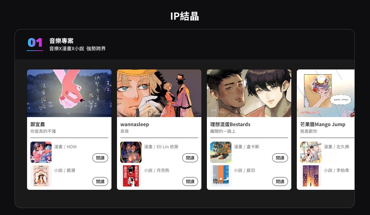

2.However, after the published, the scrollbar disappeared, making horizontal scrolling impossible.
