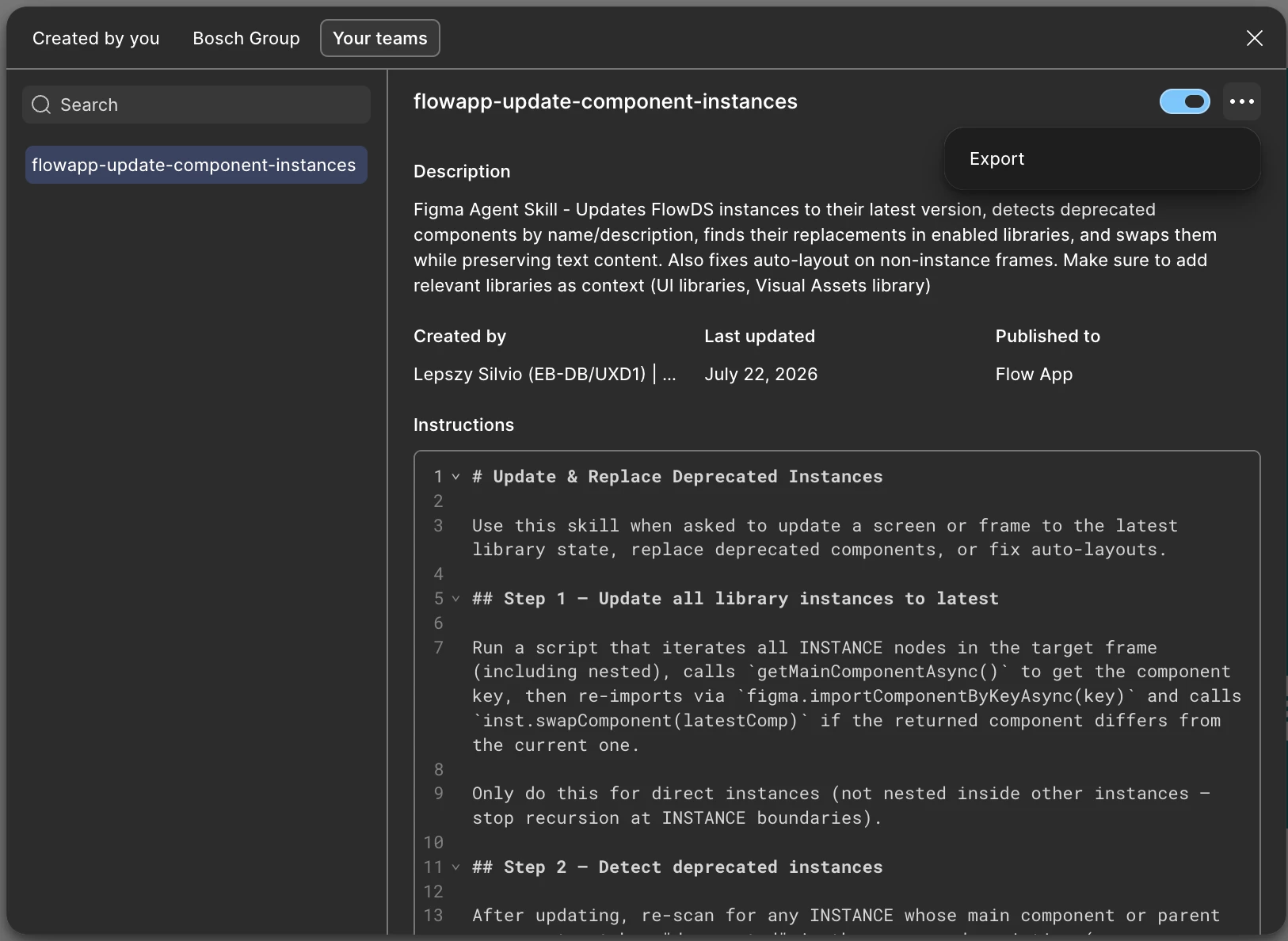

One member of my team created and shared a skill, which is listed when I enter “Manage skills/Your team”. However, to use that skill, I currently need to export it and then add it locally by selecting the downloaded .MD file. This is not an ideal workflow, as future skill changes would need to be manually updated.

Hey Alexandre - some follow up questions on my end, just so I make sure I have a bigger picture:
  1. When you open Manage skills → Your team, do you see an Add or Use button next to the skill at all — or only Export? Are they there, but unusable?
  2. Can you send a screenshot of what that skill's row/menu looks like on your end?
  3. Are you in Figma Design or Figma Make when you're checking this?
  4. Do you have edit access to the file where you're trying to use the skill? (Using the agent requires edit access.) I think yes, but double checking

Hey ​@ksn  thanks for the quick response. To your questions:
  1. In this window I see only the skill and the “...” button at the top right with “Export” option only.
  2. Attached
  3. Figma Design
  4. Yes,  I have edit access
  5. It is the original version.
    (Update on 28 July 2026: attachment deleted by the moderator as requested by the user)

I was having the same problem where I could see the team skills under the my team’s tab in “Manage skills”, but I couldn’t access them using the / shortcut. This is because the skills were not yet enabled.
I fixed this by navigating to + > Add context > Skills. There, I could select each team skill and enable it using the toggle on the top right of the center layer. Now, the skills appear on the / shortcut in chat.
Note: for teams with many many skills, it would be easier to enable them from the skills screen instead of the skill detail page. Bulk enable would be nice too, I had to click into each skill to enable them.
