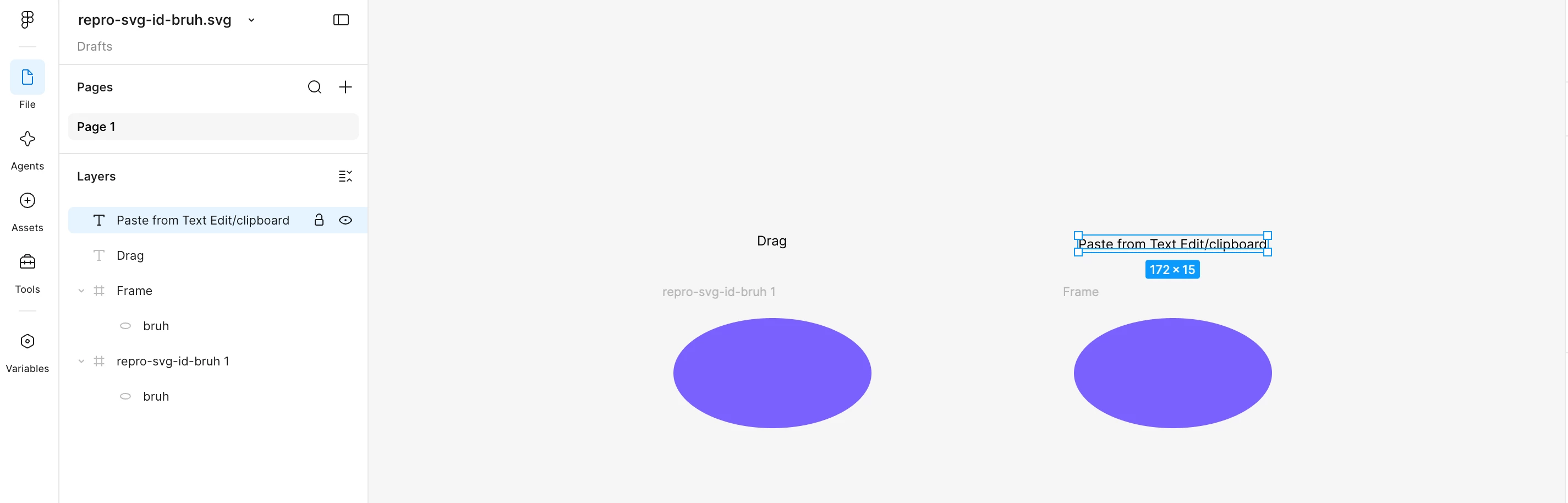

To recap what I tried: a single-shape SVG, one <ellipse id="bruh"> at the top level, no groups or wrappers. Imported into a new Figma design file by dragging the file onto the canvas. The layer came in named bruh. I also did this through the REST API (GET /v1/files/:key/nodes) rather than just reading the Layers panel — the id was preserved as the layer name.
My SVG:
<svg xmlns="http://www.w3.org/2000/svg" width="200" height="120" viewBox="0 0 200 120">
<ellipse id="bruh" cx="100" cy="60" rx="90" ry="50" fill="#7B61FF"/>
</svg>
If you run that exact file through your import, I'd like to know whether you get bruh or Vector. That single data point splits this cleanly: if you also get bruh, something about your real SVGs' structure is the trigger and I’ll test there. If you get Vector from this file, the difference is environmental and we can go a different direction.

My test was done using a my own Figma Pro account and the desktop app. Talk soon! — Jaycee
