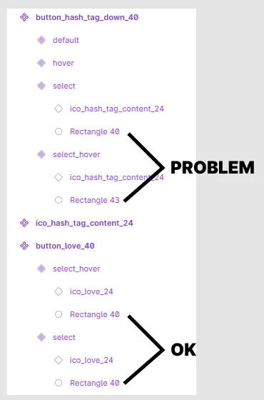

smart animation blink
1. Smart animation is applied to the two buttons.
2. The functions applied to both buttons are the same.
3. The heart-shaped button moves naturally.
4. However, the hashtag-shaped button has a flicker.
5. I'm attaching a file, so please help me

    The issue is with layer naming in your smart animation. The “Rectangle” layers in the heart animation have the same name, but a different name in the hashtag animation.You need to rename them so the names match.

    Jaesong
    JaesongAuthor
    Apr 17, 2026 12:04 AM UTC
    Thank you very much.
    Thanks to you, the problem has been solved.
