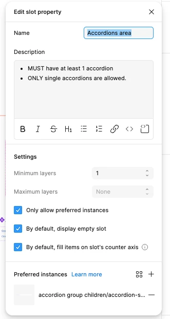

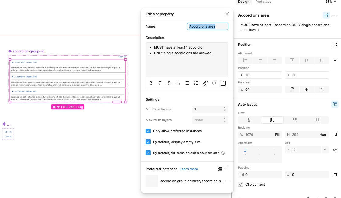

When I select ‘Only allow preferred instances’ in Slot, it still allows me to swap from ‘Preferred’ to another component. This is the case across every component I’ve tried it in.

Hey ​@Damian_Summersall 👋 Thanks for the recording, that's really helpful.
To help narrow this down, could you let me know whether you're on the desktop app or browser, and which OS? Also, when you tested this, was it only through what’s shown in the video, or did you also try dragging a different instance directly onto the slot? I wonder if the behavior is the same either way. Talk soon! — Jaycee
Damian_Summersall
Sure, it’s the desktop app on macOS 26.5.1. Yes, I hadn’t tried dragging, but I've just tried it and dragging also works. The same applies for the browser version (Safari 26.5).

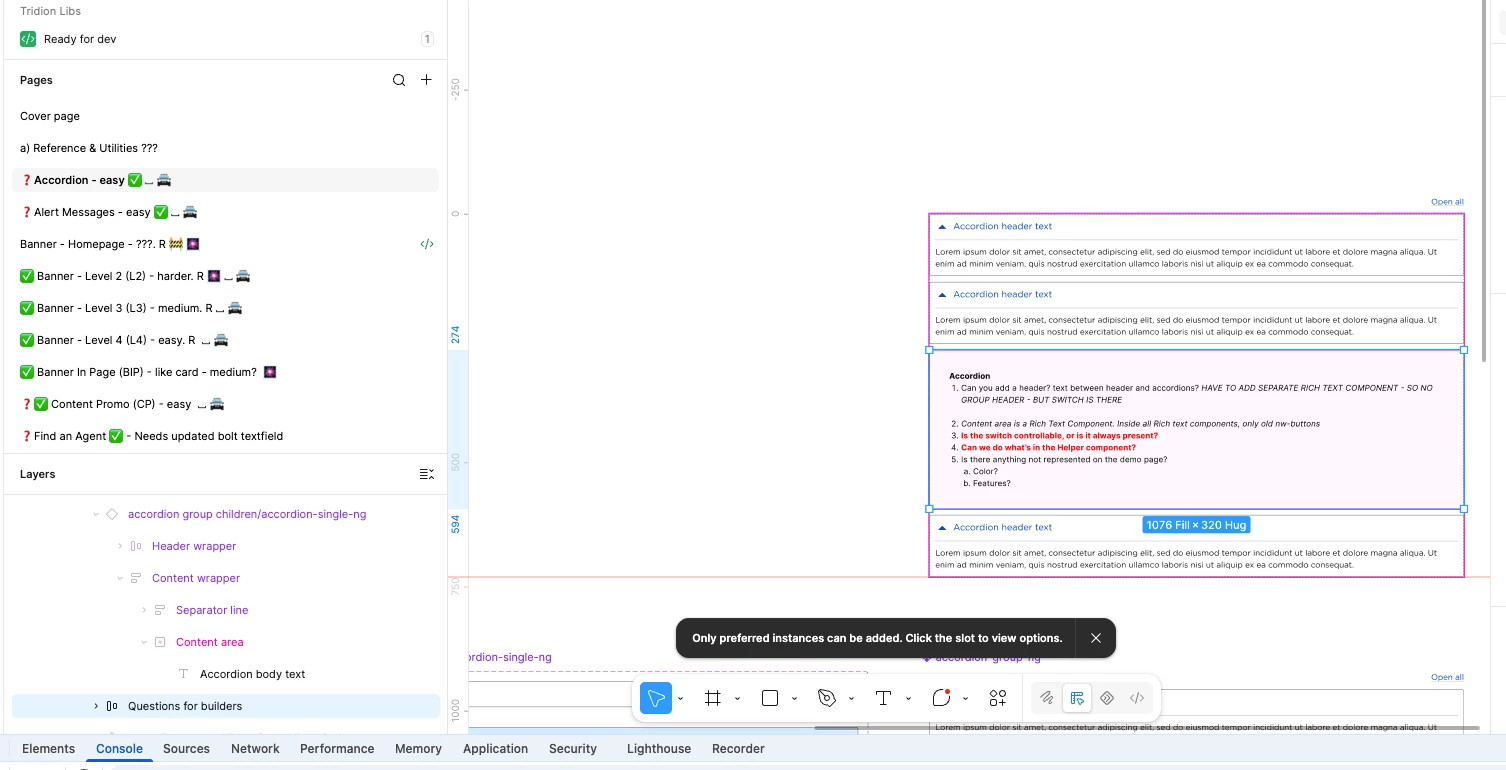

We’re having the same issue as well.
 and then dragging another component or frame into it - i receive a message, but it stays in the slot and is visible.
This seems like a behavior that would be prohibited if that checkbox is checked.

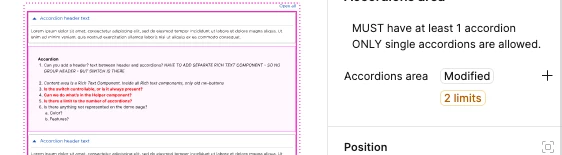

Hey, ​@jbrycedavis 👋 Looking at the Help center article and what my teammate ​@Celine_ shared above, this is working-as-designed-but-not-as-you-expect. The disconnect, to my eye, is that the setting informs versus enforces, while the popup text reads as enforce not inform. I’ll pass that along as feedback.
One question if you have a sec — with the non-preferred layer still sitting in the slot, select the slot (or its parent instance) and look at the Limits label in the right sidebar. Does it show an orange warning icon?
Thank you! — Jaycee

All i see is:

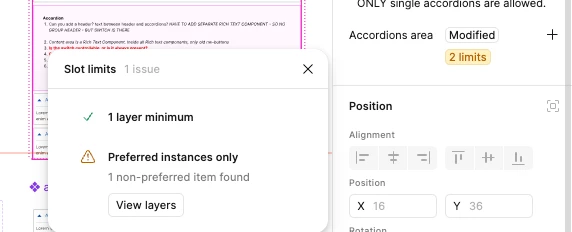

if I click on it then, yes - but there’s no affordance to even tell me it’s clickable until you told me. It looks just like the Modified above it which is not clickable - the only difference is color.
Once i click on it it looks like this:
In my opinion, when looking at the Master’s slot property’s settings, Preferred instances at the bottom (if set) are (as you put it [and I like]) Inform, but when I click the “Only allow preferred instances” checkbox, that changes my decision from Inform to Enforce/Restrict.
