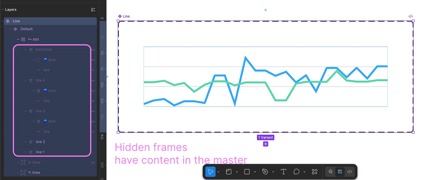

Hi team!
I found some strange behavior with Slots in instances.
Context:
  1. A component has a slot with content, and part of that content is placed inside frames — for example, in my case they are additional chart lines with dots. Frames witn the line 1 and line 2 are visible, other 8 frames with lines are hidden. Some of those hidden elements are controlled by component properties.

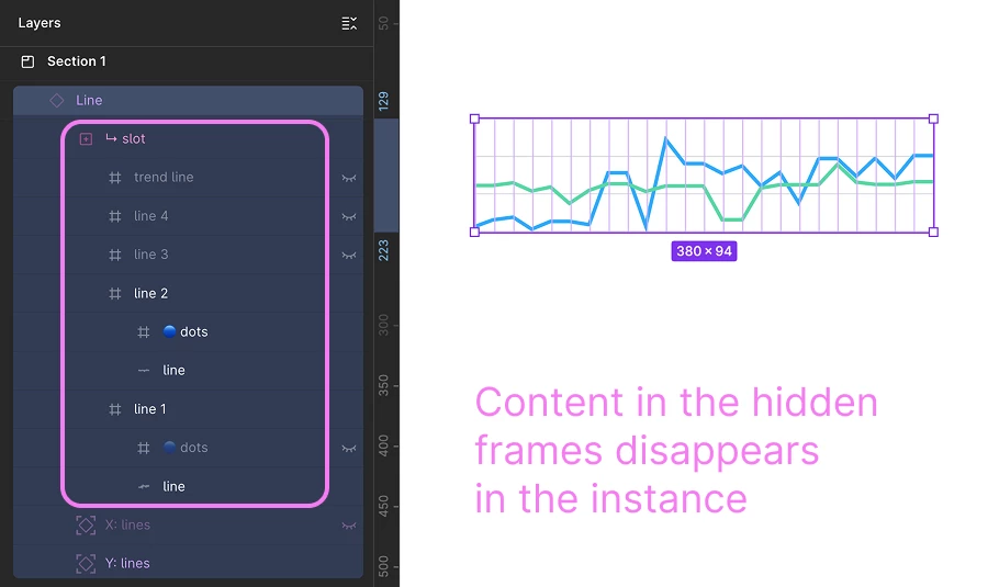

  2. If you change the content, enable or disable any of the hidden frames inside the slot in an instance, all hidden elements inside those frames disappear.

My issue isn’t about removing the slot property. My issue is about elements disappearing inside the slot. I have several frames with lines and dots inside the slot that are present by default in the slot. I’m not removing the slot property, I’m just trying to unhide those hidden by default.
More context:
These hidden frames with lines and dots inside the slot are there so a designer can add more lines to the chart or modify them if needed. None of these frames are connected to component properties.

Apologies for the oversight, and thank you again for clarifying. What you’re describing is more likely related to how slot content and overrides behave in instances. When elements exist inside a slot by default (like your hidden frames with lines/dots), a few things can cause them to disappear when you try to reveal or modify them in an instance:
  • Overriding slot content: Once content inside a slot is modified in an instance, it can lose sync with the main component. This can sometimes lead to unexpected visibility issues or elements not rendering as expected.
  • Hidden nested layers: If those frames are set to hidden in the main component, toggling them in an instance doesn’t always behave reliably, especially when nested inside slots.
  • Unpublished or “stale” slot content: If any of the slot contents were updated but not fully published, instances can behave inconsistently or appear “frozen.”
Here’s a few troubleshooting steps to try:
  • Refresh the file (right-click the tab → Reload) to rule out a temporary rendering issue
  • Double-check that those layers are visible in the main component (not just in the instance)
  • Try re-applying the slot content (remove and re-add) to see if it restores correctly
For a more stable setup going forward, we generally recommend keeping default slot content fully visible and published in the main component, rather than relying on hidden layers that get toggled in instances.
