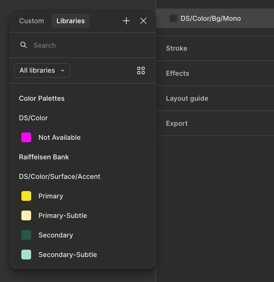

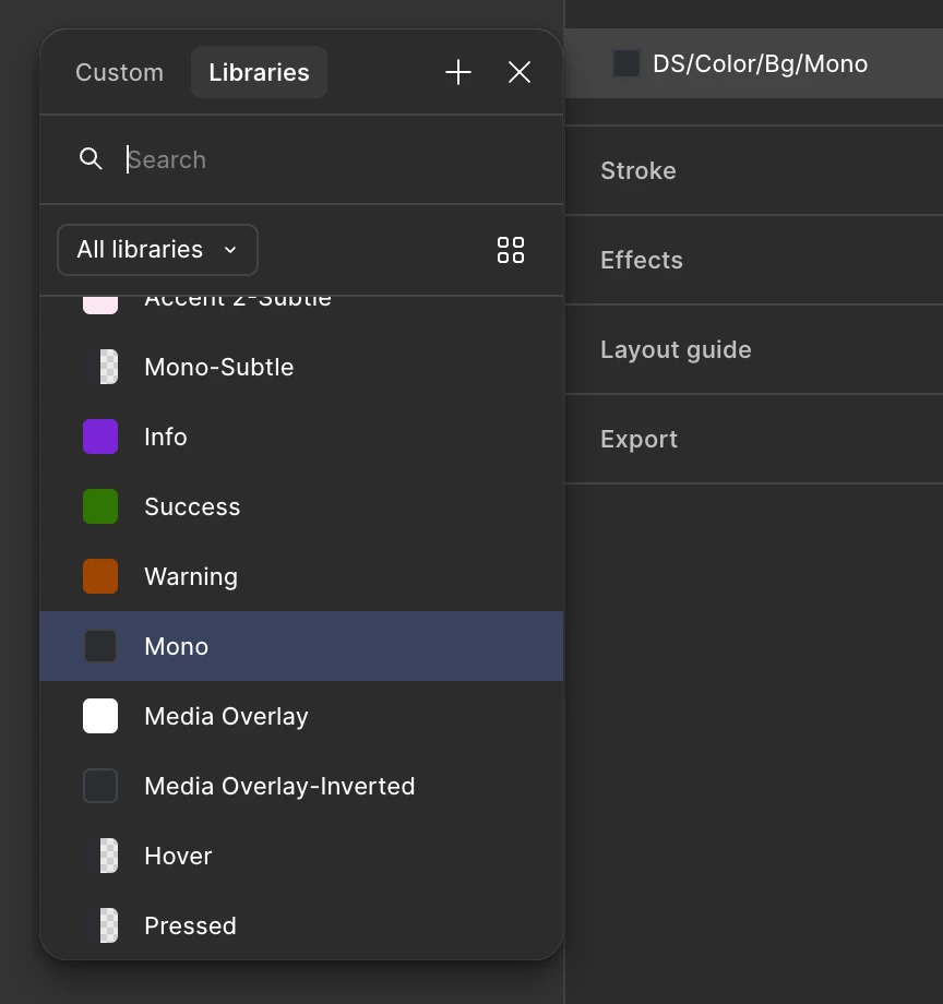

hummh
Active Member
July 22, 2026
Hello, we have the same problem.
Component changes in a library are not properly updated in slots using those components.
It looks like variables are pointing to a different version of the same file.
Its only visible when selecting the assigned color again and then it is not connected / means preselected. Only when choosing the same color again, it is connected again. But this is then treated as an override of the component which again prevents components from being updated in the future.
Before (after lib update)
After (after manually applying the same token again)
But now its an override :-(
So it looks like updates within slots do not work.
Are there any news on this topic?
At least some feedback from Figma if this is already reproduced as a bug?
