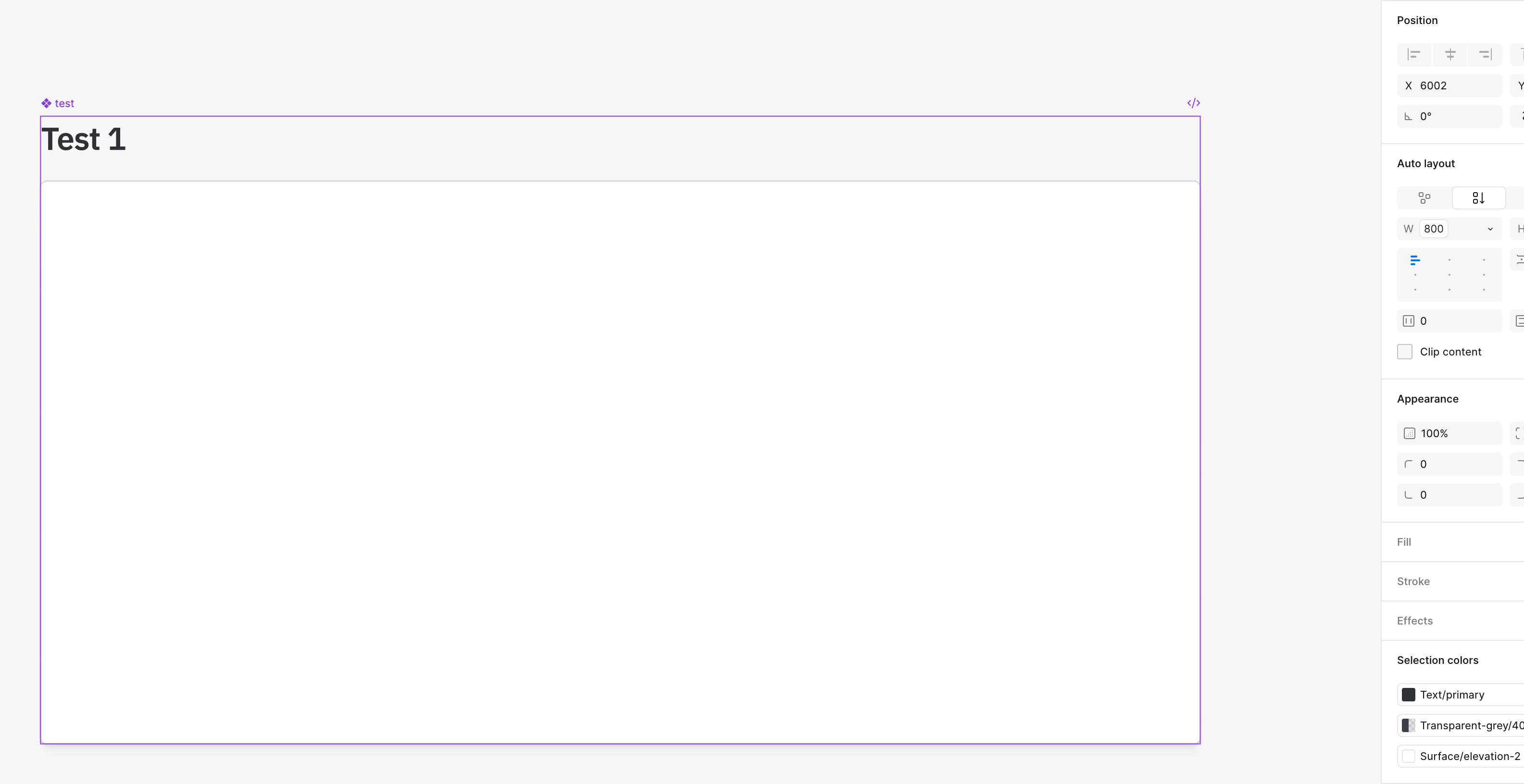

After more investigation:
The ‘slot’ component that i was inserting had it’s width set as a variable (see img). Once I detached width the variable, it kept the ‘fill’ as expected after duplicating.
I get the intention, but think I still would have expected the ‘fill’ to override the underlying ‘width’ variable after duplicating.
