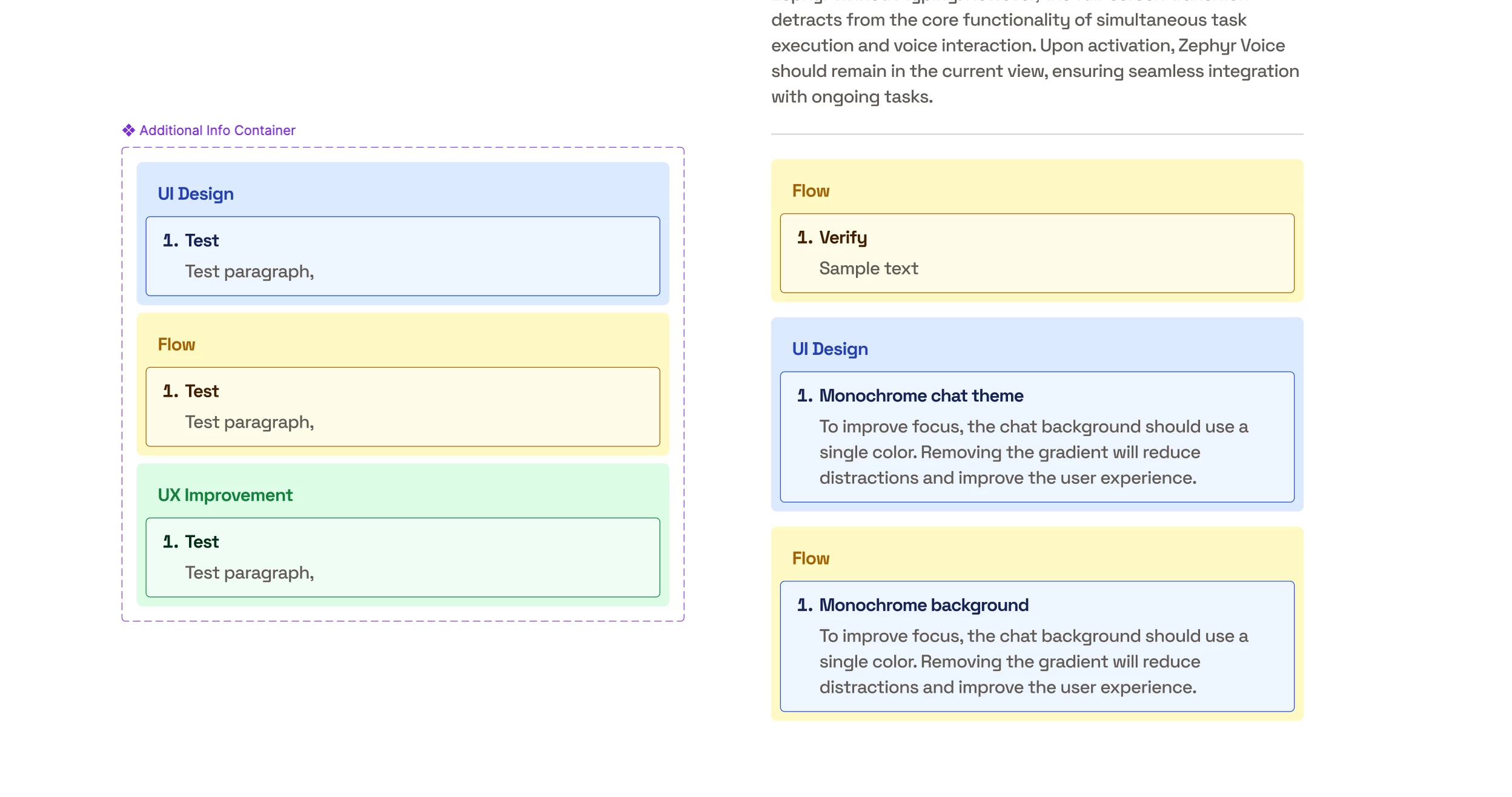

When I create a component set with variants and add slots inside each variant with different configurations, the slot does not update when switching variants on an instance. Background color and font color of the slot stay frozen from the originally placed variant.

As seen in the attached screenshot: the right side shows instances where switching variants results in mismatched colors — a "Visual Design" heading sitting on a blue background in one instance and a yellow background in another, instead of consistently matching the variant's defined style.
Currently the only way to get the correct default colors is to reset the entire instance after switching variants, which defeats the purpose of variant switching and loses any customizations made to the slot content.

I understand that when switching variants on an instance, the slot is retaining the original variant’s background and font color instead of reflecting the configuration of the selected variant.
I’ll definitely be passing this along to the relevant team so they’re aware and can review the behavior more closely — I’ll follow up in this thread if there are any updates I can pass along.

​@Celyn_L Is there any update on this? We are finding it more cumbersome than previously (before slots) to have to reset the nested instances that are inside of a slot container after changing their parent’s variant. All of the content gets lost and has to be copied and pasted back in. It seems to negate the purpose of variants in the first place.
