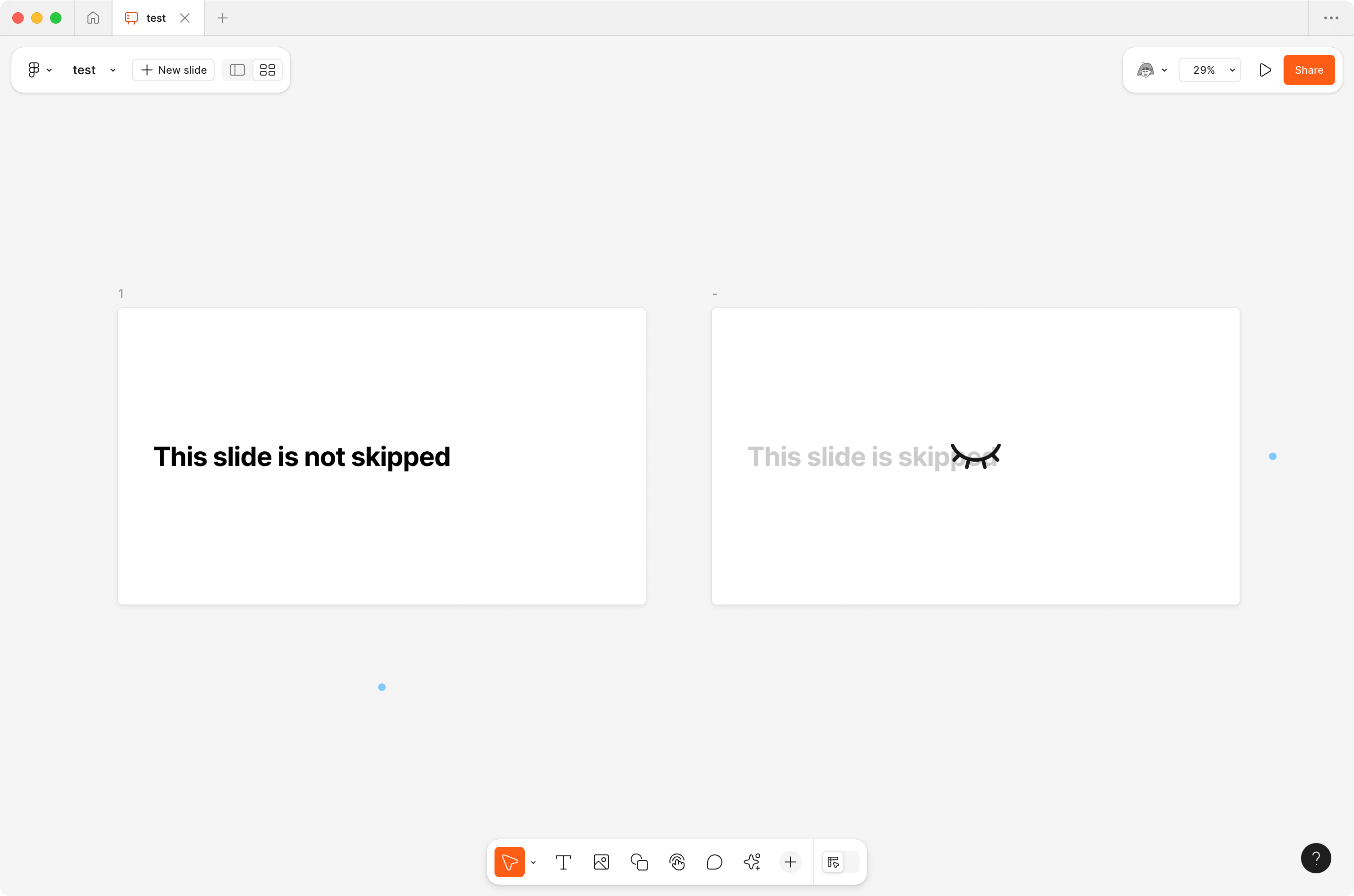

Hi ​@djv it happens with any Figma Slides files, see below a quick test to reproduce the issue:
Figma Slides desktop app with 1 normal slide and 1 skipped slide.

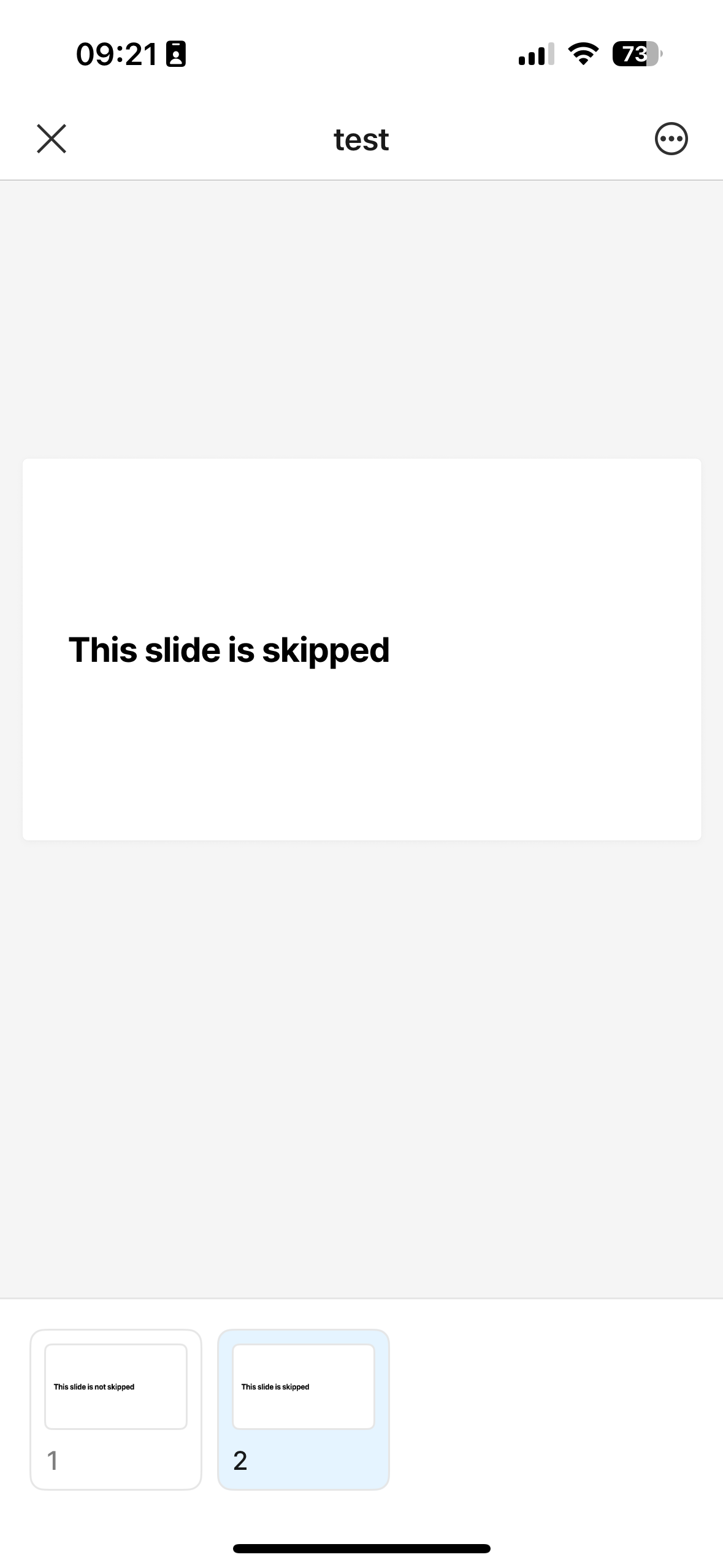

Figma iOS app with the same file, second slide should be skipped or at least show the skipped state like on the desktop app with the closed eye icon.

The Slides team ultimately determined that this is actually expected behavior. The mobile app uses the editor view, not Presentation view, which is why hidden slides showing up is to be expected. Only in the Presentation view (prototype view) will hidden slides be out of view.
