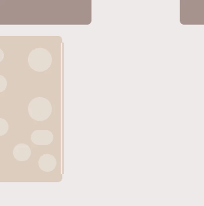

Shifting pixels on export
Every time I export a raster image (png or jpeg), some of my shapes will get jumped pixels around the flat edges of the shape. It’s seemingly totally random, and the shapes are not on fractional pixels. This will happen to me on my PC but not my Mac, and does not seem to happen to coworkers exporting the same piece of artwork. I’ve tried uninstalling and reinstalling the app, changing all my export settings, resizing… not sure what’s going on here. Anyone else encountered this?

    Update your GPU driver — this solution has helped other users with the same problem

    I noticed that it was caused by the X & Y position of the frame I was trying to export. It needs to be whole numbers, without decimals. That solved it easily for me. 👍
